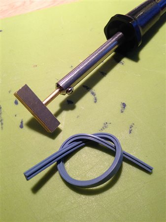

Have failed to find an easy solution to borrow a working Beolink 5000 or 7000 to clear that annoying timer on a Beocenter 2300 I start to think to try to repair th BL5000 I had (thanks Christo!).
After reading about the classic issue, ribbon cable connection becoming loose, I was so happy to fond out that some oriental country sell a special tool for this for not too much money and thought I could give it a try.
After long weeks, the tool arrived.
So today I started to open the remote making pictures to post a nice new "save your things from trash" topic on the forum.

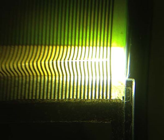

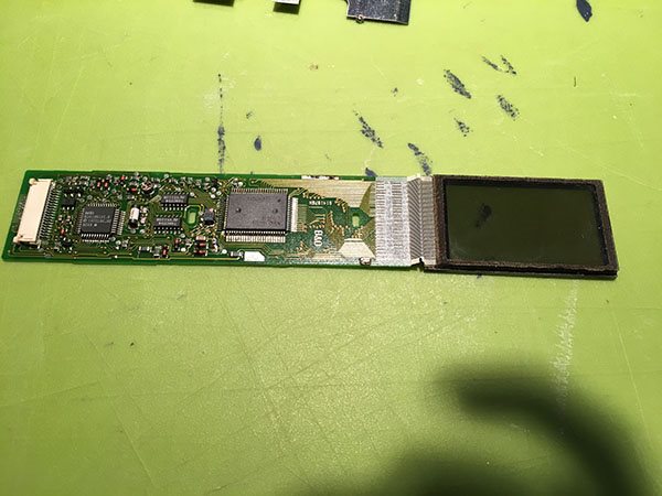

Unfortunatly, while dismantling the remote carefully taking care of the thin fragile ribbon, I discovered the tool not gonna be of any help…
The connections are broken inside the ribbon itself at a crease.
From the PCB side they are soldier point where somebody with surgeon's steady hands may bridge some wires, but from the screen side, there is nowhere to soldier anything.
