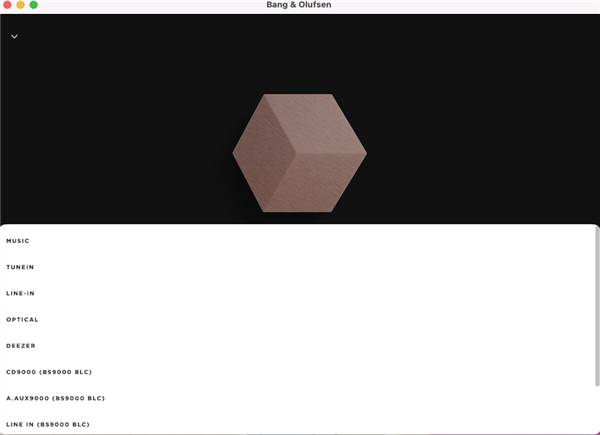

lawrencejmcook:I assume that the speakers (i.e. the Shape) are attached to the Core.
lawrencejmcook:If so, for the second pic, in which product do you tick the INTEGRATED check box? The BLC or the Core?
Note: in the BLC the "Connect to" both (primary and secondary) are set to BS9000 BLC (thus the Beolink Converter NL/ML)
Edit: the BLC is set as ASlave
