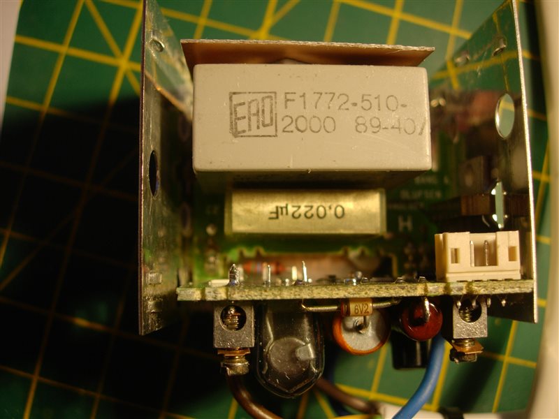

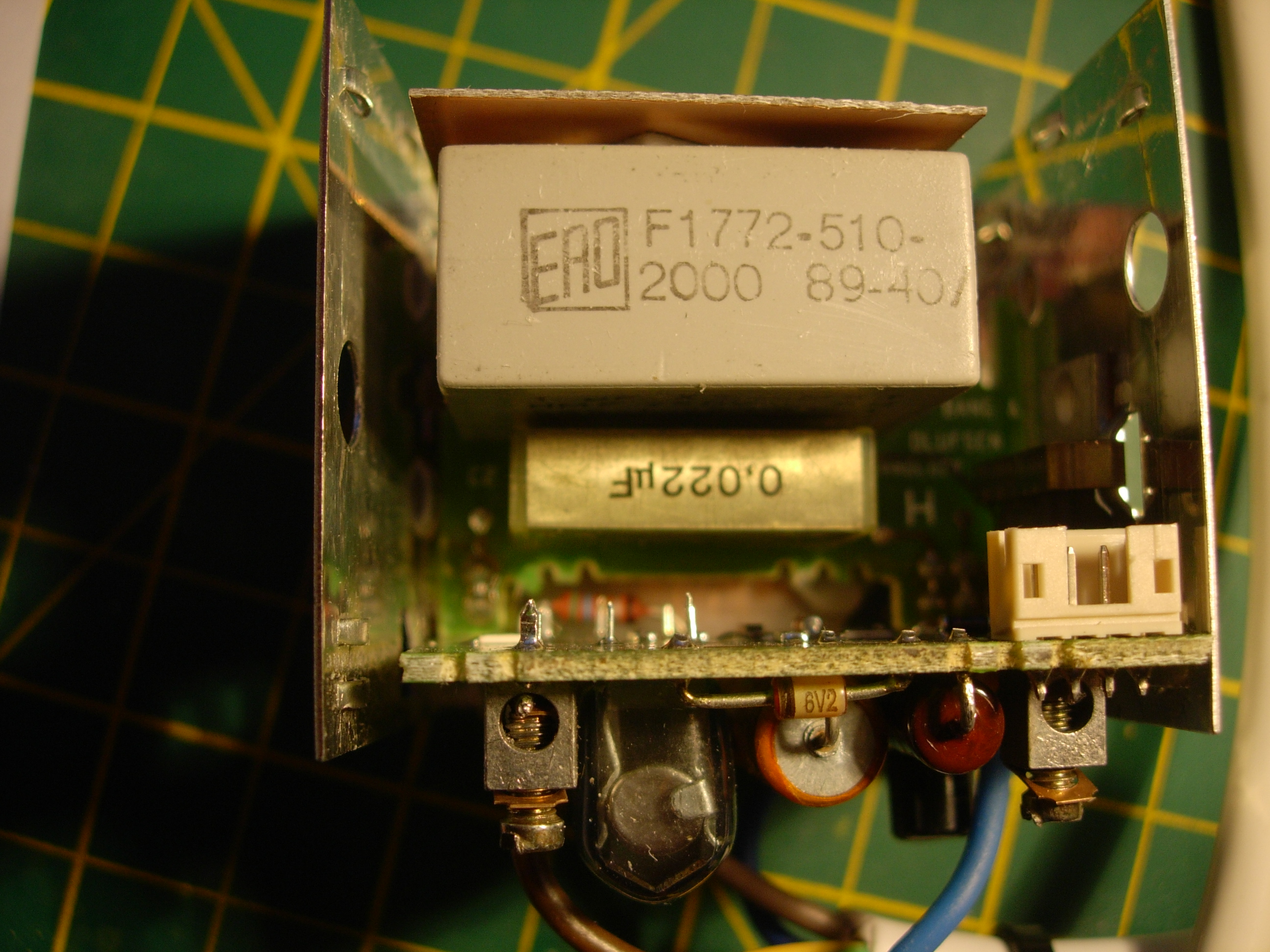

The first picture is the removed inner metal "cube" - a metal frame which surrounds the electronics.

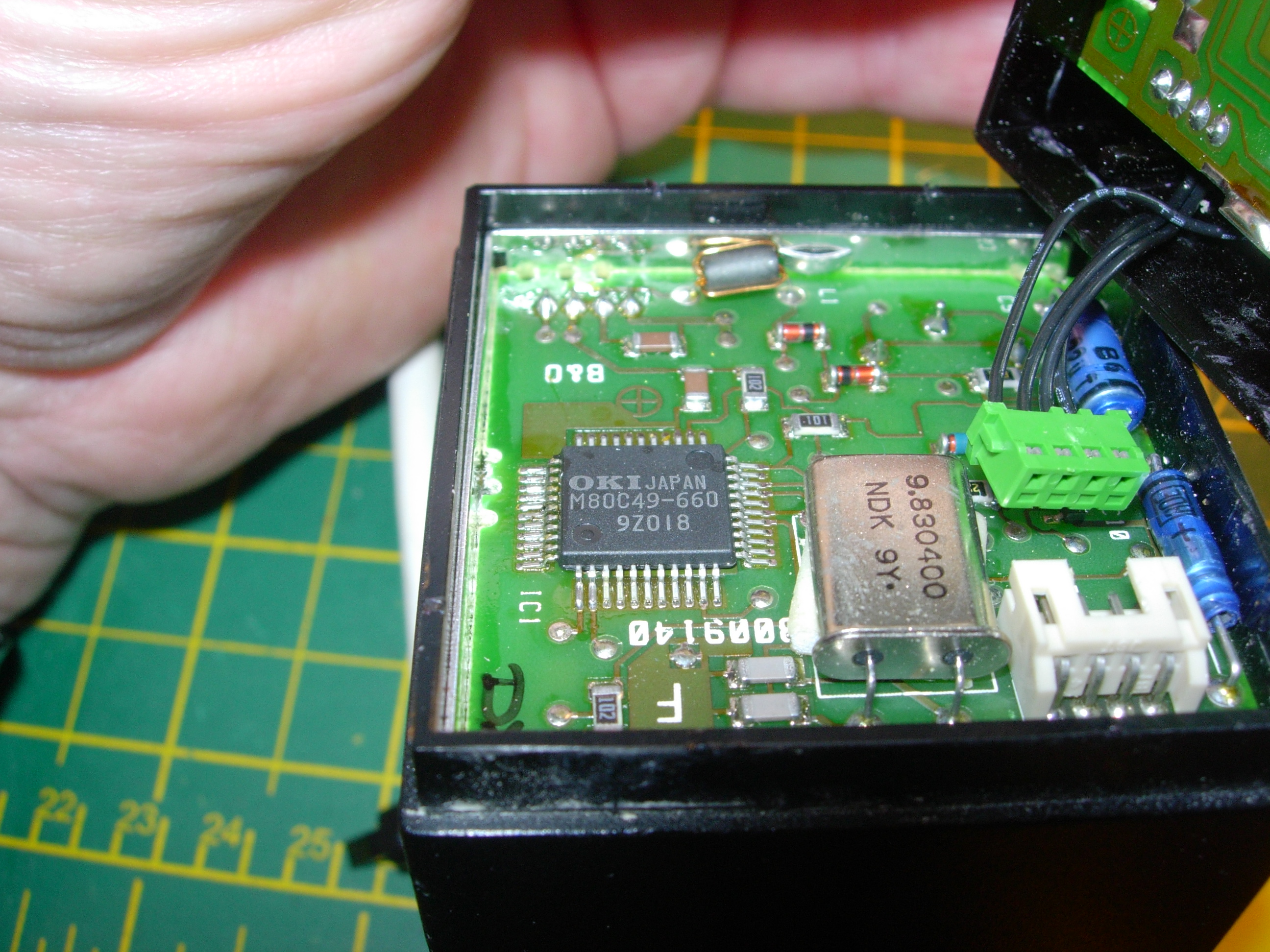

The second picture is the LC1 body with the top removed showing the connector block which accepts the connecting wire from the top
I have been able to successful repair a "dead" LC1. The parts required are readily available from CPC/Farnell and RS and other suppliers.
I replaced the two "suspect" capacitors with Nichicon 470uF/16v and 100uF/16v; these are both radial capacitors but will still fit. Vishay ones are available although I did try to stick to the same voltage settings as the originals.
The triac, BTA06-600TRG, is available and I replaced that and used a little heat transfer compound on the back of it to ensure it stays cooler. Don't lose the clip that holds it it place against the metal frame.
The battery is a 3v lithium-manganese CR2430 and should be checked - mine was OK at 2.96v - and replaced with the VARTA vertical mount one if found to be dead.
I would warn that tracks on the board can lift very easily with heat so take precautions when removing and replacing the components; low power soldering iron/small tip and use a heat sink (tweezers) if necessary. The tracks are very small and I was very lucky in that I was able to place, and solder, wire to replace lifted track around the triac.
Ensure the module is assembled correctly and carefully slide back into the base before reconnecting the mains power leads. A good magnifying glass is very useful during this repair.
