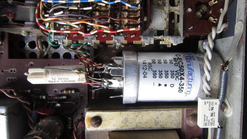

Recap Beovox Cona, not sure if this usefull but will do it anyway.
First time I opened a Cona...
And this is how a driver (M70 filler) looks like from the inside, interesting...

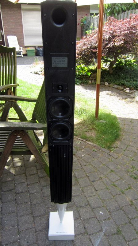

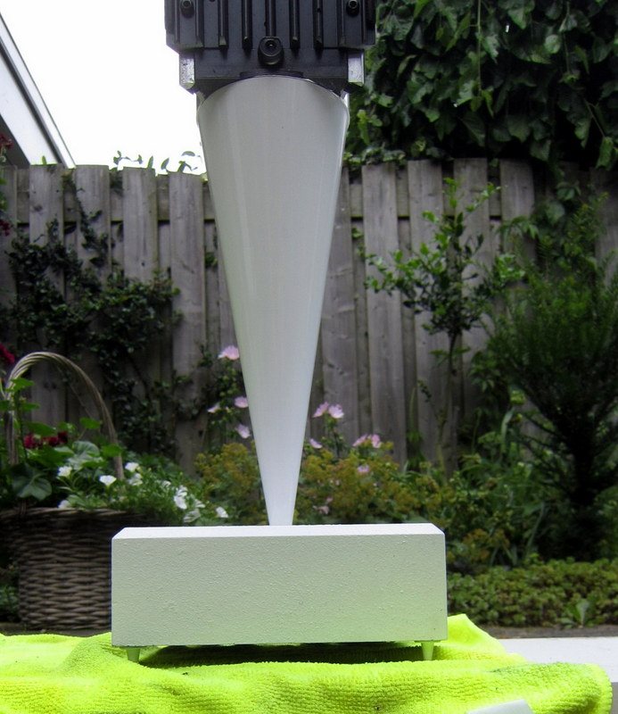

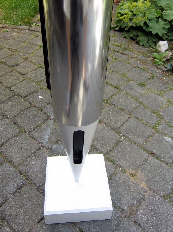

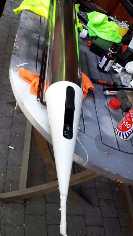

Beolab 8000, bad scratches on the bottom part of the alum. cabinet. What to do?
I might as well paint the base.
Gonna recloth the fret in white (has been ordered). I want to have it all white so I painted the fret not to see any black behind the cloth.
Which color Hmm

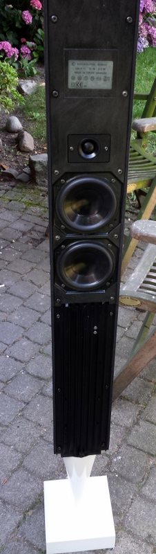

Leslie replied on Sat, Jul 19 2014 7:51 PM
Bought it from a private person. This came from a B&O dealer. Speakerset from a RL35/45?
Beautiful painting.
Unfortanetely the frame is made of plastic so I will change that into aluminium (later).
Brengen & Ophalen
Dillen
Copenhagen / Denmark
Posts 13,191
Dillen replied on Sat, Jul 19 2014 9:41 PM
I am not familiar with those speaker drivers but they are neither RL35 nor RL45.
Doesn't look like B&O, I think.

Leslie replied on Sat, Jul 19 2014 10:04 PM
Thanks for dissapointing me Martin Crying But I know it wasn't, but it came from a B&O dealer and the cloth looks familiar with the cover of some B&O CD's I have. Gonna check that!

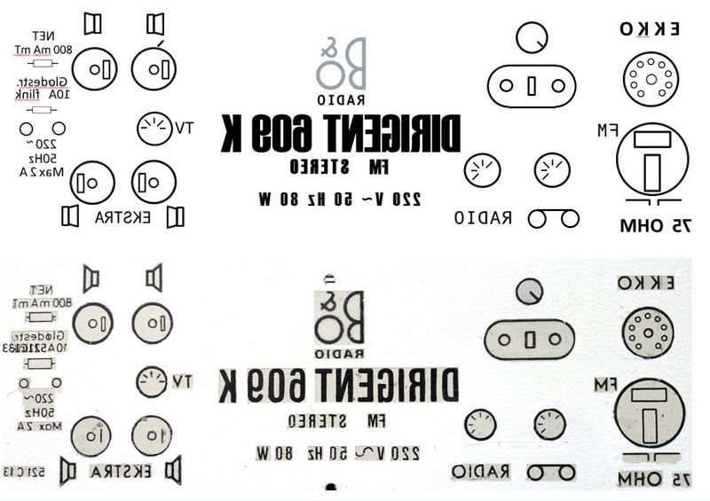

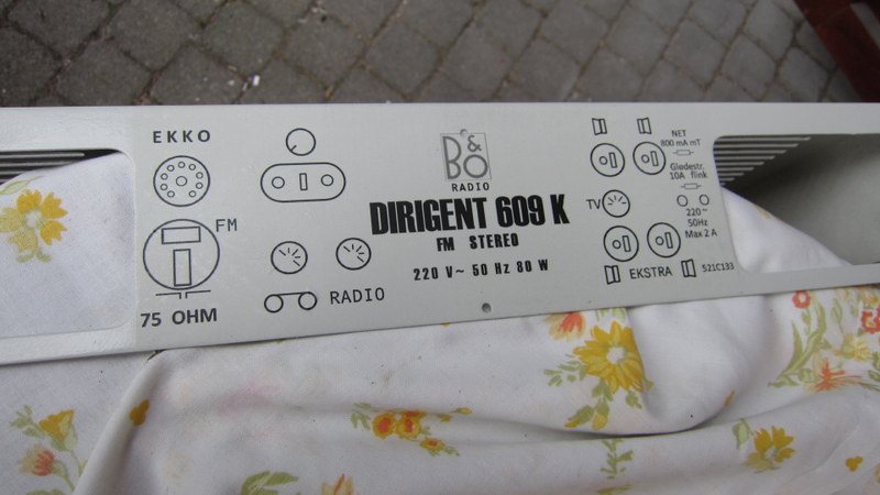

Leslie replied on Wed, Jul 23 2014 9:54 PM
Finally I finished my decal layout for the Dirigent I'm working on and found a mistake on the lay-out.
Looks like B&O made a little mistake on the 2pin DIN symbol. If you compare the plug on the chassis and the symbol you will see that it's the other way around. Spade on the symbol should be on the right side. And a little mistake on the word "Glodestrom", whatever that means. Will do it again...Whistle

BO replied on Thu, Jul 24 2014 10:09 AM
I guess i should be Glødestr.
//Bo.
A long list...
tournedos
Finland
Posts 7,357
tournedos replied on Thu, Jul 24 2014 10:39 AM
Leslie:
Or perhaps the assembly worker just riveted the sockets the wrong way around (they are not on a PCB as far as I recall, so it doesn't matter if you still wire them right)...
Can't get to my 610K (one year newer I suppose) but here's a picture of the rear panel - it appears to be the same way.
BO must be right on the wording, it means the heater current of the valves.

Leslie replied on Thu, Jul 24 2014 11:30 AM
Thanks Mika, just rotated the DIN plugs on my decal sheet. Not sure if that was wise to do but it needs to be correct.

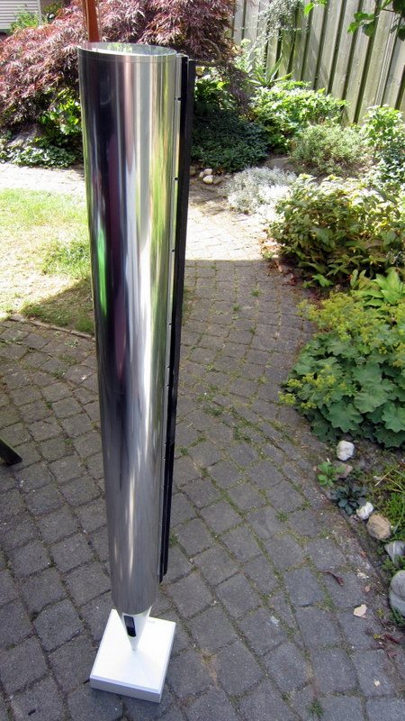

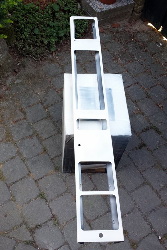

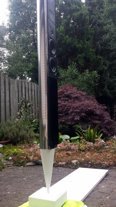

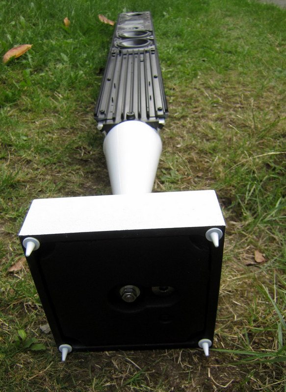

Leslie replied on Mon, Jul 28 2014 9:17 PM
Another two 8000's that are almost finished.
Hmmm, one tiny dent on top panel. Anoying..
New top panel, need to remove the speakerhousing (12 screws) in order to get access removing the panel with only one screw

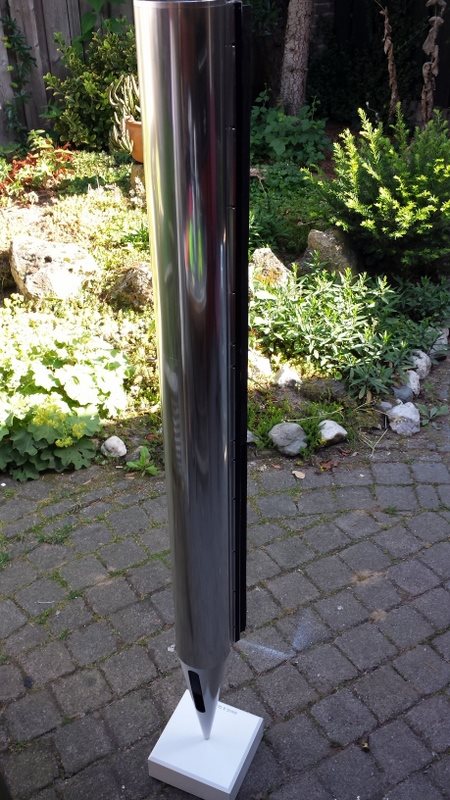

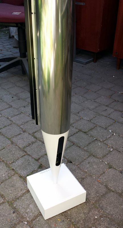

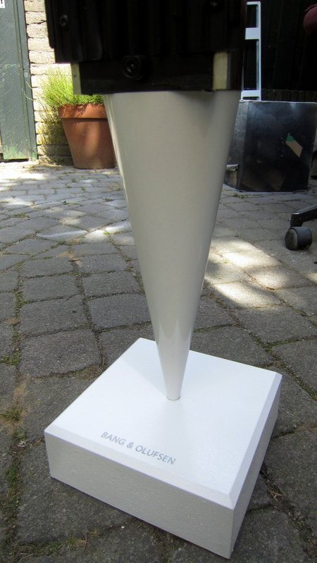

Leslie replied on Tue, Jul 29 2014 9:18 PM
After 3 attempts I finally finished my decal.
This is how it was.
And this is how it is now.
And new aluminium frames for my loudspeaker paintings. Honestly, they sound a lot better then the RL45's I have.
Next job is completing my Beolabs 8000's. 4 woofers need to be replaced. Thought the amps were defect so I swapped them with donor amps. No result.

Forgot my Cona, new caps...

Traverso
78230 Le Pecq France
Posts 132
Traverso replied on Wed, Jul 30 2014 8:29 PM
Hi Leslie,
I am always wondering the quality of your lettering works and would like to start also to improve the aesthetic of my works.
Where to start from, I do not know.
I have a practical example it concerns the lettering of the Beomaster 3000, the one with the sliders, I renovated it electronically and brought it back to life. It is this one: http://www.beoworld.org/prod_details.asp?pid=336
The area I am talking about is the front panel the aluminium where the marking is weak and the sliders marking: "Tuning, Volume, Treble, Bass, Balance"
Thanks a lot for your guidance
Alain
Leslie
Top 25 Contributor
the Netherlands City
Posts 5,423
Silver Member
Leslie replied on Wed, Jul 30 2014 9:13 PM
Bonjour Alain,
Waterslide decal. Youtube is your friend.
https://www.youtube.com/watch?v=PkawGOSFjWQ
What I did with my Dirigent is a sort of workaround. Made a picture exactly in front of the chassis.
Used Powerpoint to paste the picture as a background layer. On top of that I put all the symbols and text (many fonts available) and resized them until they fit the symbols/text as seen on the picture. Then I deleted the picture and that's it. Sorry, you need to mirror the whole lay-out and print the decal either on laser or inkjet. Simple right?
By the way, bought my decals at www.paperspecials.nl The owner Anton gave me lots of support in guiding me. Thanks!

Leslie replied on Wed, Jul 30 2014 9:20 PM
New caps..

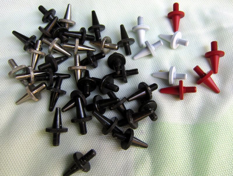

Made my first attempt to reproduce the knobs for Dirigent and 608 valve receiver/amp.

valve1 replied on Sat, Aug 2 2014 8:56 AM
Leslie:
 Leslie, I am impressed by your relentless pursuit of detail Yes - thumbs up

Im going to guess the knobs go onto a  round bar with a flat side ???
Are your replica knobs hard enough to take a thread ? There are some work arounds if not.

There's no threaded hole inside, just a square nut that needs to put inside. Have those and if not I'll make them,  no sweat. In the mean time I made more knobs. First I had a shortage and now I have plenty. :-)

Leslie replied on Sun, Aug 3 2014 8:40 PM
Knobs almost finished...
Now I can complete my 608 amps and 609 Dirigent.
