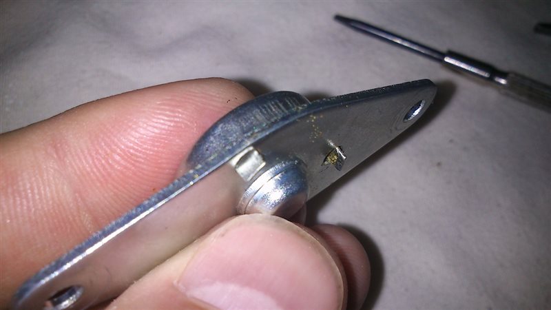

Beogram 1200 motor, no spin, very hot
This post has 42 Replies | 4 Followers
Christian Christensen
Stockholm
Posts 512
Christian Christensen Posted: Thu, Apr 24 2014 11:56 PM
The motor axel is not stuck , I can twist it manually around smoothly, but starting it, the axel doesnt spin, and the motor gets incredible hot.
Dead motor ?, de-assembling motor ?
Any tips ?

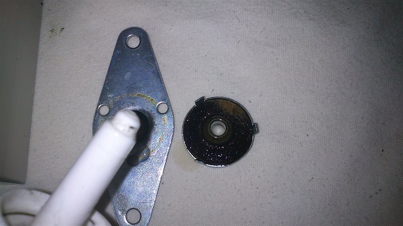

Hmmm, what is turning "smooth", relative ?
Read some old post in archived forum, that referd to some lese post I didnt find about relubing the 1200 motor.
Anyway, took it apart, so what to lubricate here ??

As I see it you will have to pull off the plastic cap, under there there must be a bearing, and you will have to get the rotor out, the drive (pulley) is probably beneath, and below the rotor there must be a bearing too. This motor is different from my 1202 motor.
Dillen
Copenhagen / Denmark
Posts 13,191
Dillen replied on Fri, Apr 25 2014 3:20 PM
It's probably not rotating shaft in bearing but bearing in bearing housing.
It needs a complete overhaul.

Show us pics from the rotor, bearings and bushings when you have it all out.

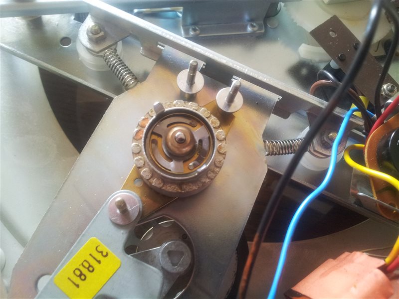

Stockholm
Posts 512
Thanks Søren and Martin
I understand the electromagnetic princips of a motor, but this is the first time in my life I open an electric motor.

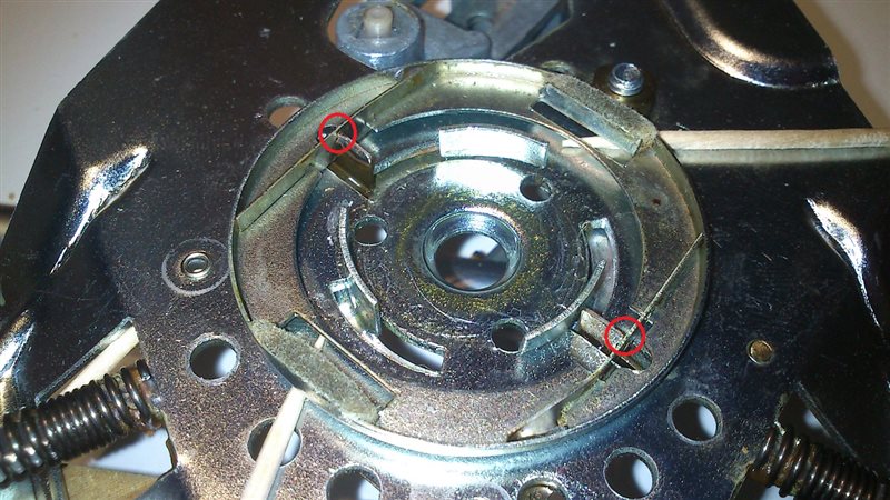

This is how it look after removing the plastic cap.
Where do I go from here ?
I will gladly show pictures, but where do I find the bearings and bushings ??

tamtapir
Örebro, Sweden
Posts 521
tamtapir replied on Fri, Apr 25 2014 4:45 PM
I ´m dealing with exact same problem but has perhaps come some hours longer.
Will the points I indicated with red on the picture be soldered or will they be fitted in some other way?

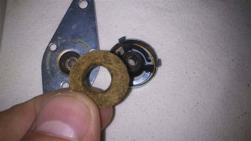

Christian,
The bearing is the apprx 10mm diameter bronze part that still sits on the chromed motor shaft.
It may have seized solid in the old, dried out lubricants.
Losen with the aid of a little acetone.
Martin

Christian Christensen:
You will have dismantle the rotor, to get to the other bearing, probably take out the whole base plate and then pull off the the wheel or pulley off the rotor shaft, and then pull out the rotor.
And as Martin mention clean thoroughly with acetone, polish the shafts with very fine abrasive paper or green 3M hand pad,  the bearings I clean with acetone inside, and then roll a very fine (400 grain) paper around a small screw driver and rotate it inside the bearing, and then again clean with acetone, this until the bearing is totally clean, Test on the shaft, that the bearing rotate free, if not, sand and clean again. Assembling lubricate with sewing m/c oil or Liquid Bearings.

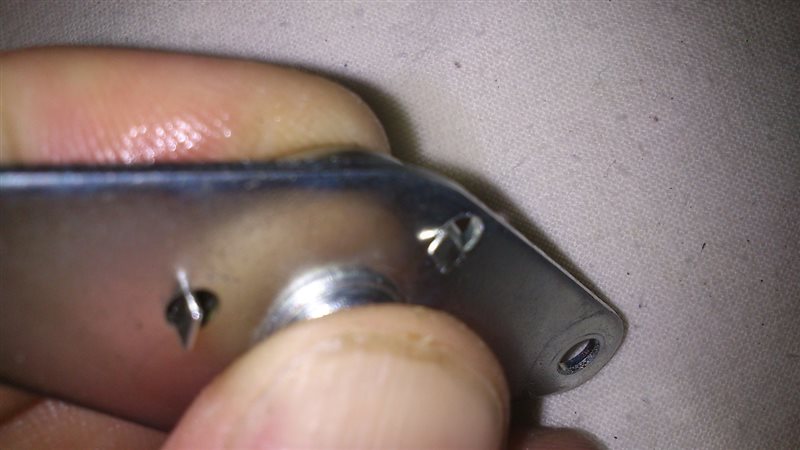

Stockholm
Posts 512
Thanks again Martin and Søren
Yes :) Acetone made me get the bronze bearing of.
I can see green..oxide ?
And why is some of the kogs of the rotor damaged ?
I can see that  tamtapir has managed to get the rotor off.
How  ?, cant see what to do.
Loosen and take off the nuts, red arrows, lift off the whole plate. The springs will make it come off with pressure. You can now get to the other side, note the placement of the nylon spacers below the plate on the fastening pins.

Dillen replied on Sat, Apr 26 2014 11:58 AM
The two protruding tabs are not damaged. They are ground off to balance the rotor.

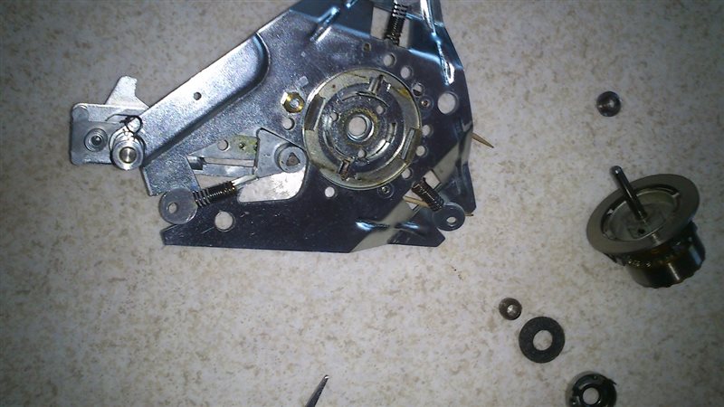

Got the rotor mechnism off, realize that belt needs to be replaced as I see rubber mess.

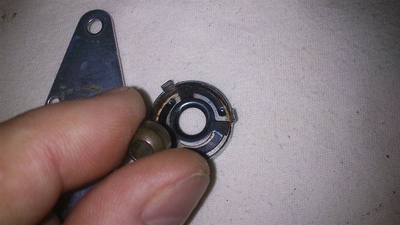

This is my phase now.
I have some cleaning to do.
But what to do with the rotor now ?
Is the axel of the rotor supposed glide individually from the rotor ?...a bearing inside there, between axel and rotor ?
Trying to turn the axel with my fingers it is seized.

The shaft is fixed to the rotor, but below the drive cone there is a bearing, the drive cone is normally pressed on the shaft, but check for small screws holding it. For belt try Axel. got mine from him. Works OK.
Now is a good time to dissemble the rest of the drive mechanism, there will be a lot of old hard grease in there

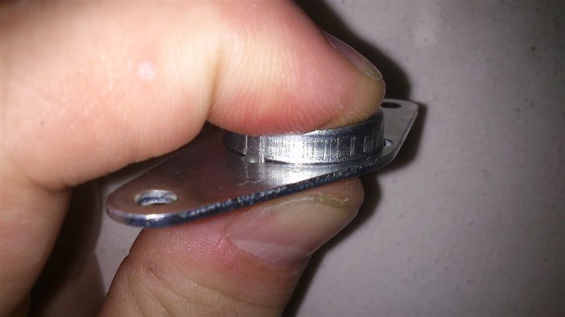

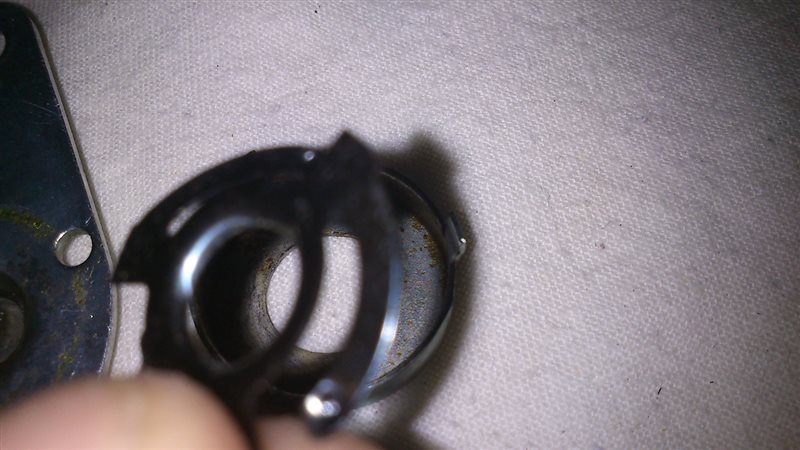

Dirty axel of the drive machanism dissambled , cleaned and oiled, easy, rest of the drive mechanism looked well and worked well addade just alittle bit oil there.
But back to the rotor.
I dissambled the drive cone with help of aceton in the search of the holy bearing I have been looking for all the time
No bearing there.
Cleaned and oiled....ahhhhhh damn.
Now the drive cone slide so smooth that it doesnt stay on.
What to do ?

A bearing can be a roller bearing or a bronze bushing, in your case there must be 2 Bearings (Bronze bushings) 1 at each end of the rotor.
Dillen
Posts 13,191
Dillen replied on Sun, Apr 27 2014 8:33 AM
Christian,
That's not the drive pulley, it's a bearing...

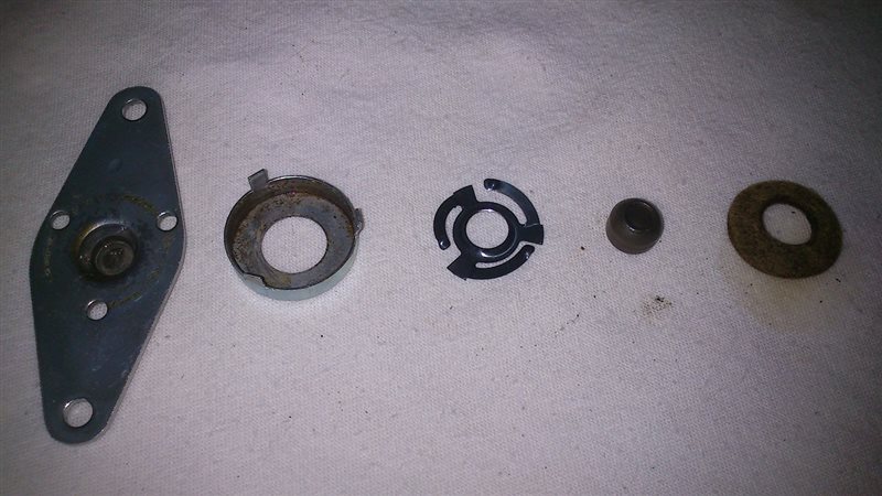

Since I do not find any blueprint shoving the motor in any of the service manuals, I have in av naive style, made a sketch of how the splitters hang together in BG 1800 (and in BG 1000). Observe that over the rotor will the stator be mounted before ”the lagerhus” is  fastened with two capnuts.
chartz
Top 25 Contributor
Burgundy, France
Posts 4,171
chartz replied on Sun, Apr 27 2014 10:18 AM
Thanks for the useful drawing Yes - thumbs up
By the way, has anybody found a solution for a noisy, hardened rubber idler wheel? Acetone dripping silences it for some time (a few days) then noise comes back. It has no dents.
I was lucky enough with my belt from Germany, it works 33-45 back and forth. I replace the platter with 4 LR20 batteries to put it in place and observe it work.
Stockholm
Posts 512
Thanks everybody.
Mechanics is not my quality, in phase of learning.
When I was 15 years old, I built speakers, while my friends repaired moped enigines.

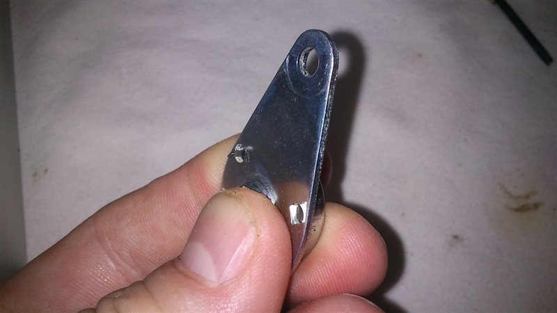

My blueprint was not as good as Tamtapir, I put deails and screws in different bowls, representating different assemling processes, which I now realize was not good enough.
So I need help comming back.
filt fabric between bronze plate and drive mechanism ?
The little white platic ring btween bronze bearing and drive cone ? ( as it sits the same ring on each side of the rotor base )
The bronze ring on the table I have forgot where to put.....

I still have assembling problems to solve
Seems a bit tricky to get the back bracket of the enigine fit and lock and make motor spin smoothly.
I have made some error with drive mechanism, as it doesnt walk onto drive cone, while operating the the motor start switch.
