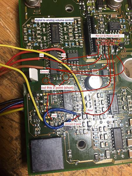

I have fix it !!

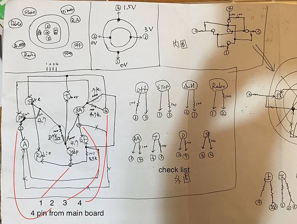

sorry , I will add english explanation , today, and the control schematic
hi
the picture show the main board , mod digital to analog VR with 100KA VR
# this picture show the control schematic , 4.7k ,7k, 8.7k
the check list is for you to check witch pin need to connect
the new control board
hope can help everyone who have the same problem !!
Can someone ( hcw6424 ?) tell me the resistors value regarding the central keys of the touch panel (<> go ...)?
. In the control schematic picture I can't read the values.Thanks
