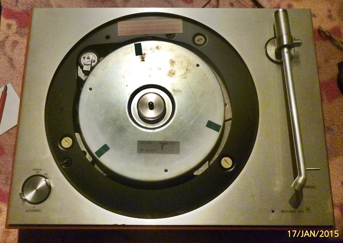

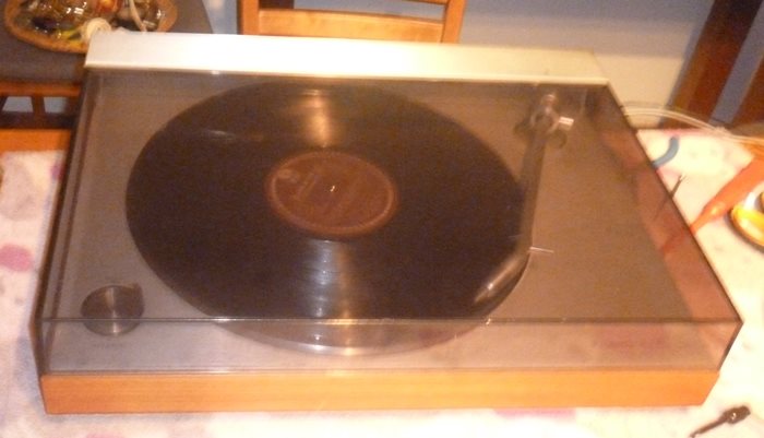

As I did a small service on my TX2, I also dug out the BG 3000 type 5231, that Rich gave to me, he shipped that one together with a tweeter he also gave me for free. He wouldnt let me pay for shipping either.

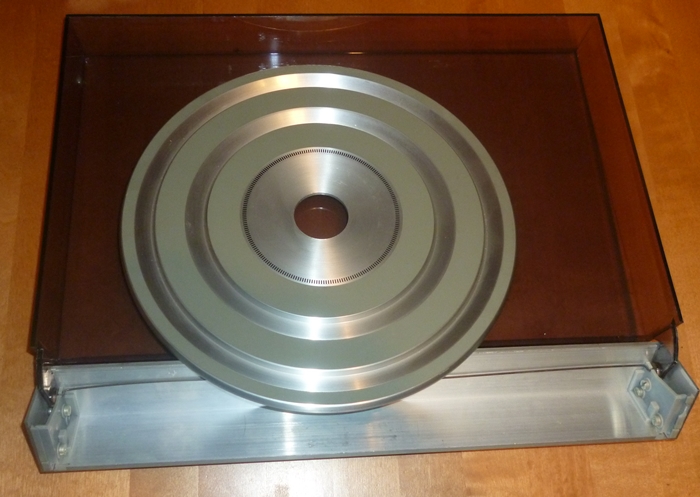

But here goes: Took off the cover and the platter, the 3000 is different from the 1202, the innards are nearly the same, but the 3000 has a fixed cover that opens, and the platter has gray rubber stripes, where the 1202 has a "take off" cover and pegs as record supports. But the cover for the 3000 is very easy to get off, just loosen the 2 screws to the back holding the bottom cover, then it slides out complete to the back of the unit.
Took out the screws for the bottom cover and the wood frame also came off. And the unit is free to work on. If you buy any BG open it up before connecting it, you never know what you find inside.

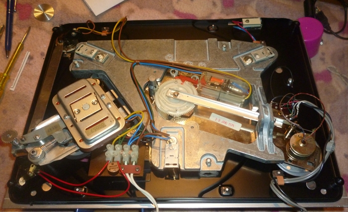

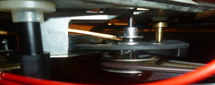

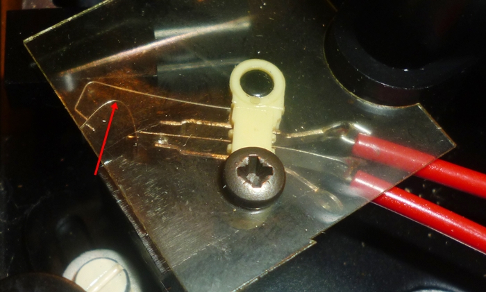

Turning around the unit, out came a flat blade spring, I didnt recognize it at once, but poured myself a cuba, and there it was, from the motor on off switch ( red arrow) I put it back where it should be and adjusted the switch.

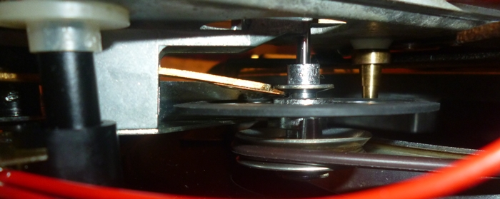

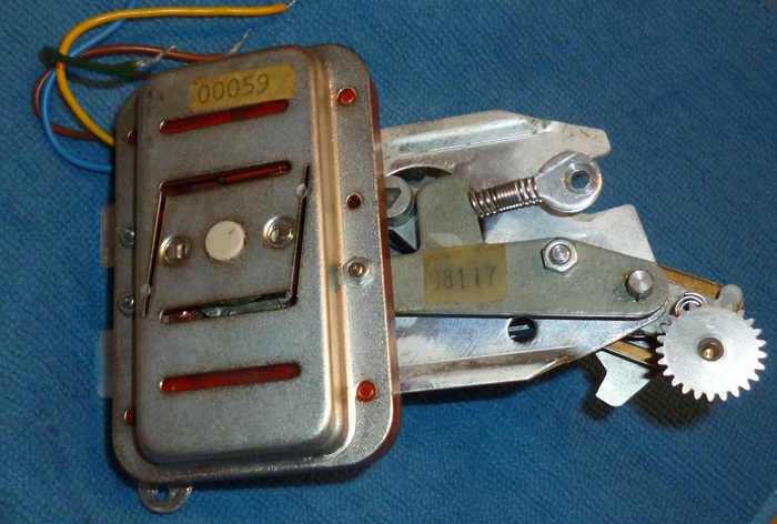

The rubber drive wheel was inserted upside down, and the guide under the wheel, I took out the drive/motor assembly and put it in like it should be, the speed adjustment arm may be bent, but I will have to correct that later when it all is assembled correctly and functioning. The pic is taken upside down.
A couple of drops of oil, and I connected the BG, the speed switch in off position, I pressed lift, and the platter started spinning, the tonearm went into the record, no cartridge attached, I cached the arm and brought it toward the middle, the arm returned to the the rest position. I then selected the on position, the platter started spinning, pressed lift, and nothing happened, pressed lift again various times, nothing. Something is wrong with the relay or a switch, will check that tomorrow

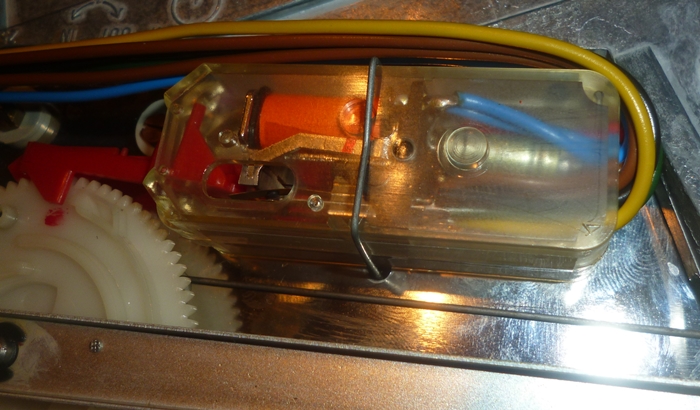

Opened the relay, the contact pins were bend and not making contact, straitening helped, the lower of the two arms did not make sufficient contact to the plastic arm on the cam gear I adjusted the relay position with the factory sealed adjusting eccentric, I checked he cap, diode and resistors all measured OK.

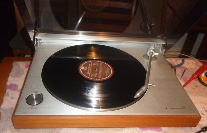

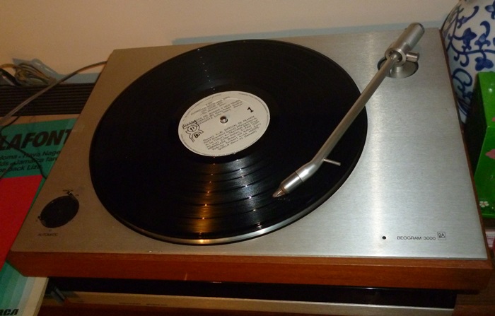

Assembled I found the counter weight touched the cover when reaching the last 2 tracks on a LP, readjusted the counter weight and the tracking force scale. Now working properly with a little nearly not audible rumble from the drive, not audible in the speakers when playing. Rich if you want the the BG 3000 back, I can ship it to you from TX next time I go up there.
The top cover needs some work, and I will have to find 4 screws for the bottom cover, the bottom cover has a hole in it that has to be repaired. but sounds good with a used SP14 bought in DK

Been traveling, Didnt see your post until now Rich, When back in Mexico I will give the BG 3000 a running test, at least 5 LPs a day for a week, and I will check that small motor noise again. And then it goes back to you Rich. Do you want a 5 pin DIN plug on it or keep the RCA connectors.

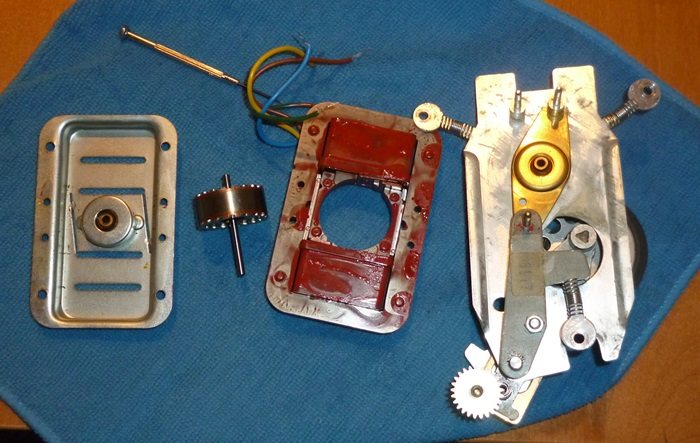

I did not like the noise from the motor, so I took out the motor and took it apart, cleaned the bronze bushing and adjusted the motor 2 step pulley to correct position on the motor shaft, that did it, there are no noises now, running totally silent. I will now have to find out how and when to get it up to McAllen and ship it back to Rich
