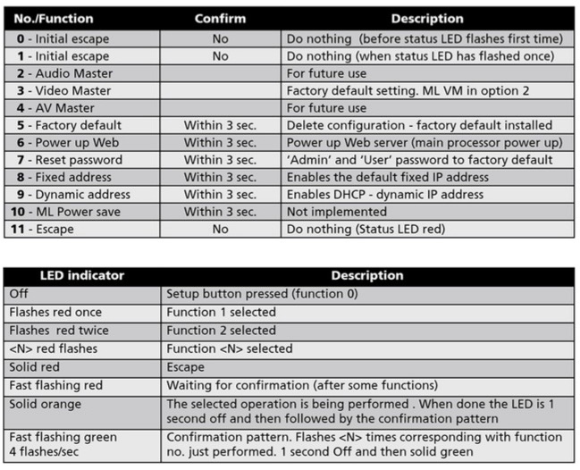

Setup button functions & LED feedback
The setup button can be used for several functions during normal operation of the BeoLink Converter NL/ML. - To select a function, the setup button must be pressed and held until the desired
function has been reached. The number of times the LED flashes red is corresponding to the actual function. When the setup button is released and the LED starts flashing red, the setup button must be pressed once within 3 seconds to confirm the function. Some functions do not require confirmation. The LED will change to orange to indicated that the selected function is being carried out. The LED goes off for one second, then the LED flashes green <N> times corresponding with the function number just performed and at last the LED goes off (normal operation).
Example no. 5 (factory default) - Press and hold the setup button until the LED has flashed red 5 times.
Now confirm the function within 3 seconds by pressing the setup button once. The LED will now change to orange to indicated that the selected function is being carried out.
here is a small list, because I could not upload a screenshot from the manual.
Example no. 3 (factory default setting for Av-Master, ML VM in Option 2)
- Press and hold the setup button until the LED has flashed red 3 times. Now confirm the....
Example no. 7 (reset password, Login:admin and PW:user)
- Press and hold the setup button until the LED has flashed red 7 times. Now confirm the...
Example no. 9 (enable DHCP activated in the factory reset before - only if you messed up your IP-Adress!!! DHCP is now factory default)
- Press and hold the setup button until the LED has flashed red 9 times. Now confirm the...
copyright Bang & Olufsen

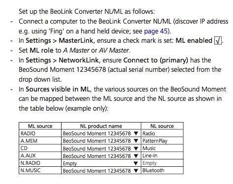

Dear Norman,
did you read my posts above? have you tried the reset. I had exactly the same issue like you, no volume control, some buttons on the remote didn´t react.
The reason is: That your converter is still reacting as AV-Master instead of A-Master. Your configuration needs A-Master!!!
All troubles went away after I did a factory reset (see above). Log-in into the converter user: admin PW: user
afterwards I changed from AV-Master to A-Master, choose your MomentSerialnumber, than map the buttons as you can see on the installation guide Page 16. Save!!!!
Restart by pulling the power cord. Start again and all your problems should be solved.
