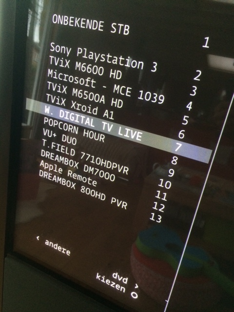

I doubt that the STB chip for the BS1 has WDLive.
The PUC for the BS3 can be programmed for use with the WDLive (I have one here)

The PUC table on the Beosystem 3 has to be updated with the service tool which is available only to B&O technicians if the WD Live entry is not on the list. Check first if it is already loaded on your future Beosystem 3.

Beobuddy
Top 25 Contributor
Utrecht, The Netherlands
Posts 3,972
Done mine.
