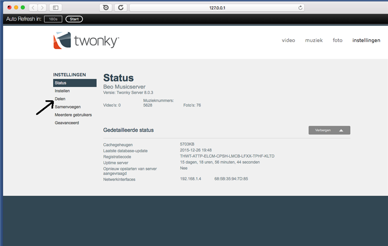

Hi,You have given some interesting answers on my C questions:C) if Twonky server is running on the Mac, do you understand how its working > NO? Do you understand the GUI > NO? Have you given your Twonky server a name > YES? Did you point Twonky server to your music directory > DON’T KNOW?I try to answer them with some pictures.- Click right at the top menu icon, and open click Twonky Server settings. You get this:
In the window click on Sharing:
In the window that now opens, you point (browse) to YOUR music directory, in my case (careful, I don't use iTunes!) its /users/... Now save this settings.
Click the MUSIC tab, and in a short while you must see all your music appearing, if not reload the window.
Thank you so Much for that Chris. For the First time i Can see My library under "Music" in Twonky now :-) Thats a start :-) Under "setup" where must i mark!? Under "mobile" Classic Media navigation" "iPod like" "by folder" or "advanced Media navigation"...!!???

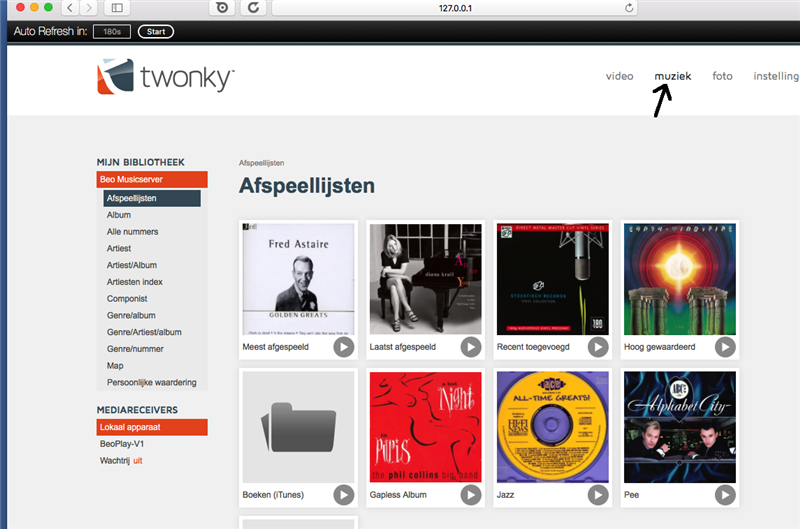

Go back to Twonky as explained before: go to the Music tab; go to Playlist (left) can you see your playlists?

Follow the instruction of Chris + Goto Twonky Settings , Setup (second option) : the Server Name given there must be chosen on the Moment.
See Chris' example: he named his server "Beo musicserver". So he would have to choose "Beo musicserver" in the menu of the Moment
