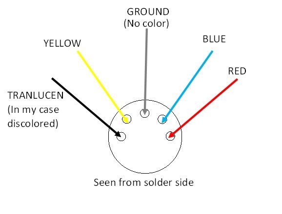

I have not taken my VX sensor apart, but if B&O have been consistent with their colour codes you should be able to connect the MCL2A sensor to a 3.5 mm stereo jack plug so that you can use with the VX.
For the 3.5mm jack plug, connect the Green wire (+5V supply to sensor) to the tip, connect the yellow wire (IR data) to the middle section and connect the Brown wire (earth) to the Outer connection closest to the base of the plug.  Leave white and grey (serial data and clock - both not needed for VX) unconnected.  I think this should work so give it a try!
(Edited - I initially listed yellow and white the wrong way around!)

I slowly return from the dead (the flu) and has taken hold of a relatively simple problem on Beocord 5000 4715. It was clear that some former owner has opened the 5-pin DIN connector for any purpose so I figured it was best to check the contents. When I opened it was a red wire loose and shortly went the adjacent blue cable.
 I have two manuals, "Service instruktion" and " Teknisk produktinformation " as physical books and the owners manual in pdf. In none of them I can find the order in which the colorful cables will sit in the connector.
 My sketch shows lead from solder side and I was wondering if it is correct if I solder the cables so.
Søren Mexico
Mexico City
Posts 6,411
Here in Danish, lower right is the plug seen from solder side pin 1-4 is tape sound in, 3-5 sound out, 2 is common ground, colors are different, but your pic looks right
Hvid=white, Gul=yellow, Rød=red, Sort=black, 2= ground

tamtapir replied on Tue, Feb 12 2013 2:05 PM
Søren Mexico:
Thank you, Sören.
I soldered the two loose wires and now I have sounds from both channels on this beauty!
