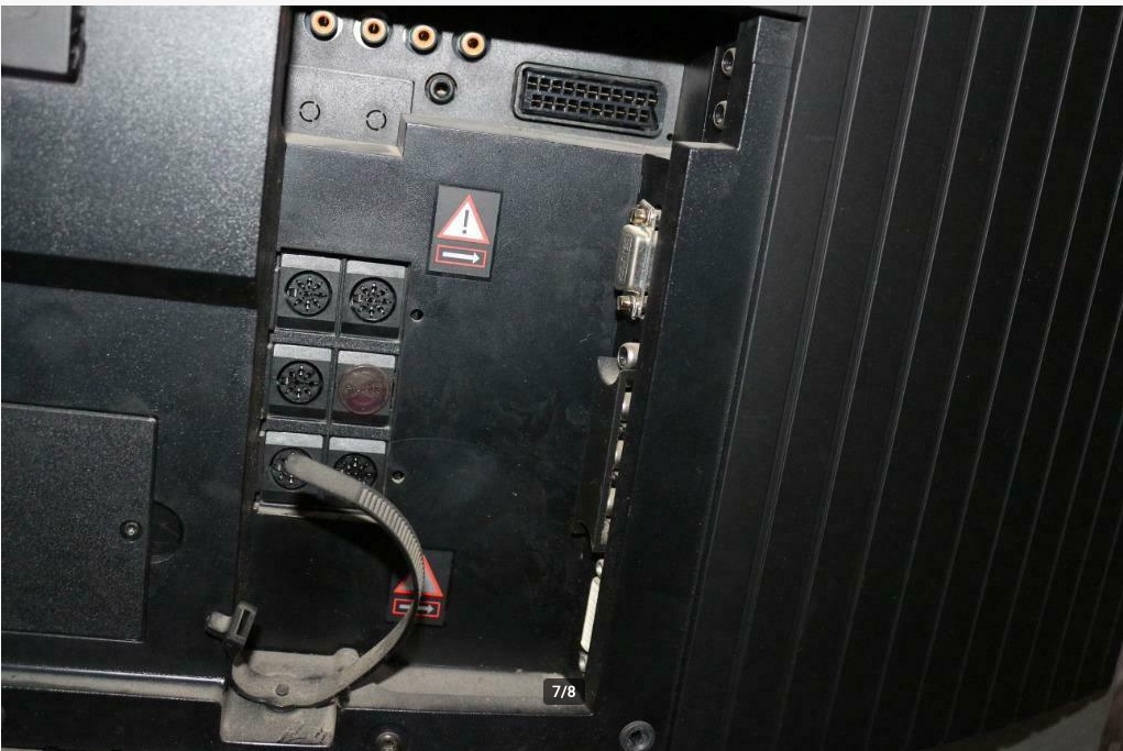

The audio output from the extractor is analogue hence should be connected to the BV7's PC sound sockets - Red and White phono/RCA connectors. (EDIT: Socket panel 2, to the right of the AV3 SCART connection)
Many thanks Guy. Still looking for that connection, my 7.32 is a mk1 so I think it may be something of an issue. Against AV4 the only audio connections are the digital ones. So I need to see how to get round that. Adrian
I don't have a 7-32 but I am 99.9% sure that there is an analogue sound input of Left/Right Phono sockets. Maybe look in the right hand side of the connection panel - you probably have to insert the connections sideways.
Perhaps someone else on the forum with a Mk1 7-32 could confirm the location???
Guy, you are right, there are two connectors on a 9311 in the top right of the right hand socket bay. (Not my TV or photo though):
