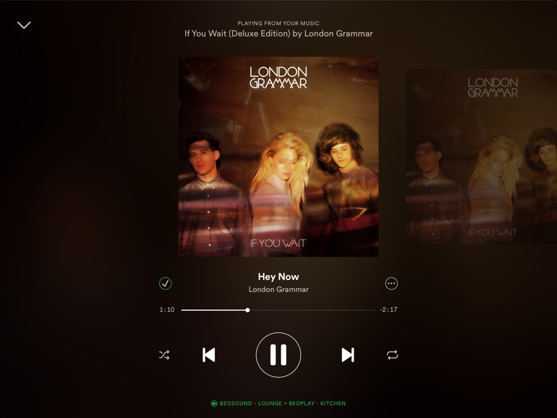

When i get it to work, spotify connect shows the two speakers as linked
