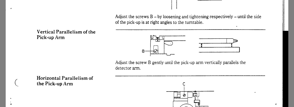

I have! However, I can’t recall what I did to make it drop. I want to say I made an adjustment to screw of the left of the tonearm.
Sorry I can’t be more help.
I can't locate my manual. Can you be more specific on the screw?
Sorry about the delay..... attached is a picture from the 8000 that I used.
Thanks..I found a manual online and it has the same picture. Gonna clean it up and see what happens. Will let you know how it goes.
