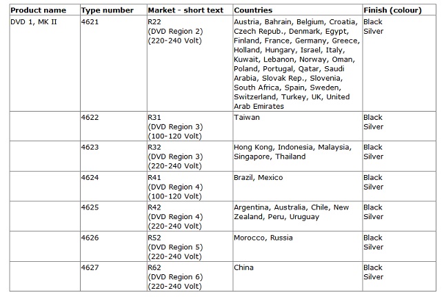

Hello everybody,I am the proud owner of 2 MX7000 tv's and 2 DVD-1 players (4620 & 4621) which are in daily use.
Can anyone tell me what the different codes: 4620, 4621, 4622, 4623, 4624, 4625 and 4627 stand for?
I am looking forward to your reaction.
beophilip7000
DVD1 Type # 4620 is a Mark 1 version
Type # 4621 through 4627 are Mark 2 with each of the different type numbers are for different regions and power as below
Regards Keith....
