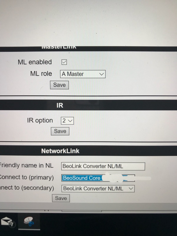

When you write “BLC as audiomaster connected to a beosound“.... Does that mean that you also have an other Beosound (Masterlink Version) connected? Or is it just the Beosound Core
Søren
You Can only have one AudioMaster and one Videomaster in a Masterlink system, that means that if you have the Beosound 3000 connected in option 0,1 or 2 you must setup the NL/ML converter as A.slave.
