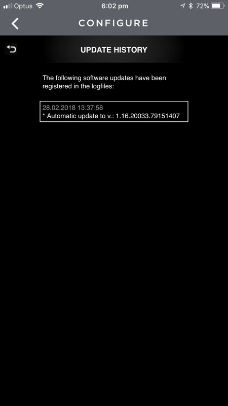

Alex,
should I update the remote or the main unit? Can you pls advise on the procedure?
the firmware I have is 28/2/2018 so it is the last one.
Any other thoughts?

thanks so much for your help. The new software update works perfectly.
