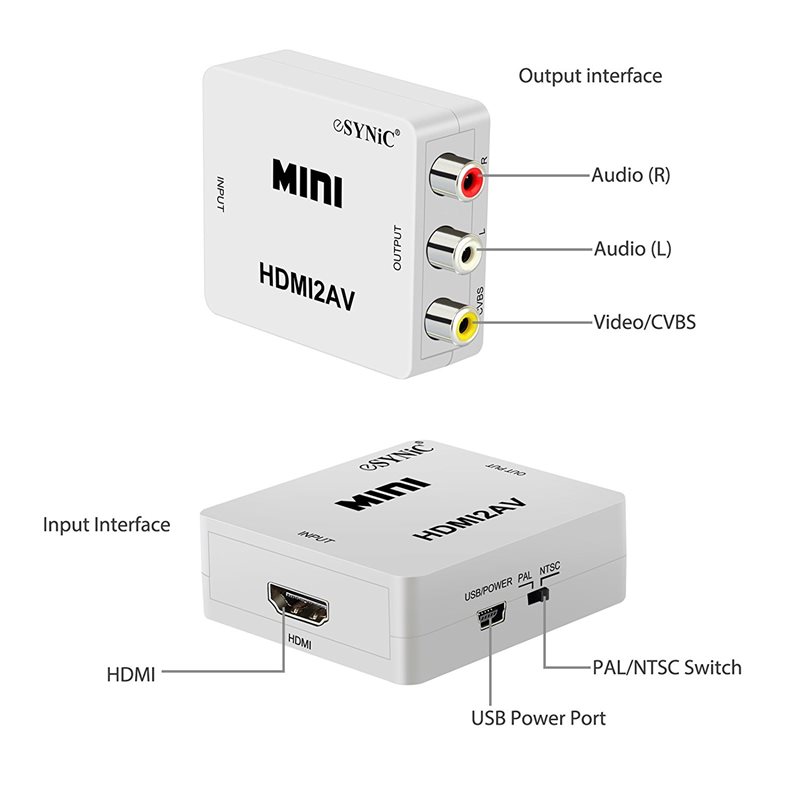

Maybe this one or similar could do the job
https://www.amazon.co.uk/BW-HDMI-SCART-Composite-Converter/dp/B00NAT0W2Y
I used one of these for my HDMI only FireTV to my BV5
And one of these to connect to the TV via the scart
All from Amazon. It worked brilliantly.
I'm currently using it with my Beocenter 1 TV and FireTV.
PS. You need to ensure any converter is HDMI in and not HDMI out as my first purchase was the wrong way. You need to check it with the scart adapter too as they can also be in or out. The one I have has a switch on top the says IN/OUT .

Try this one.It worked with my old BV3
https://www.ebay.co.uk/itm/302564158065

Yes - these will work - but I want to avoid Composite video ( the yellow, CVBS) in favour of the (better) RGB component video signal.
I know that RGB out on digiboxes via a scart - scart cable is better quality , so looking to keep this picture improvement in the HDMI to scart conversion.
So the connection will be digibox > HDMI - SCART ( RBG) > TV - rather than digibox > HDMI - SCART (CVBS) > TV , if that makes sense.

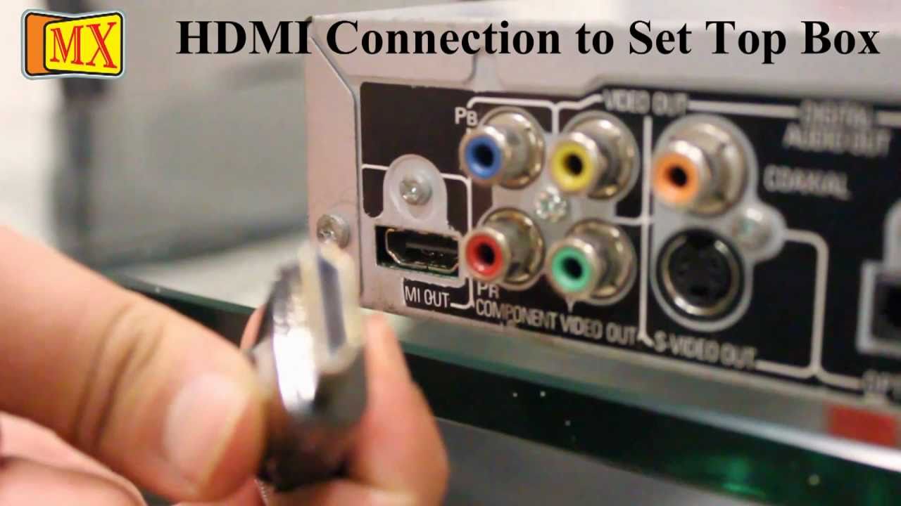

I'm unsure, as component and RGB seems to be interchangeable terms - and I know for a fact that the Pb, Pr, Y outputs on early DVD players and SKY boxes ( as pictured above) work into the RGB enabled scart sockets on the avant chassis ( which is what the BV5 MK1 is, for AV inputs).

I tried this converter to feed my Avant 32 RF MKII two months ago: https://www.amazon.com/Musou-Component-Converter-Adapter-Coaxial/dp/B01F6URXYY. It has Component Video (YPbPr) output. Avant has component RGB input. I was unable to get picture.
My understanding was that both are component signals, but different anyway. RGB is red, green and blue computer convention. YPbPr is luminance, difference between blue and luminance and difference between red an luminance and is a broadcast convention.
When I had my BV5 I tried to connect a Silver ATV 1 using the component out from the ATV with scart converter and got nothing. I tried many suggestions over a few weeks with no luck. That is why I originally bought the HDMI adapter I suggested in my earlier post. In the end I wanted the FireTV so I got rid of the ATV and attached the FireTV to the adapter.
