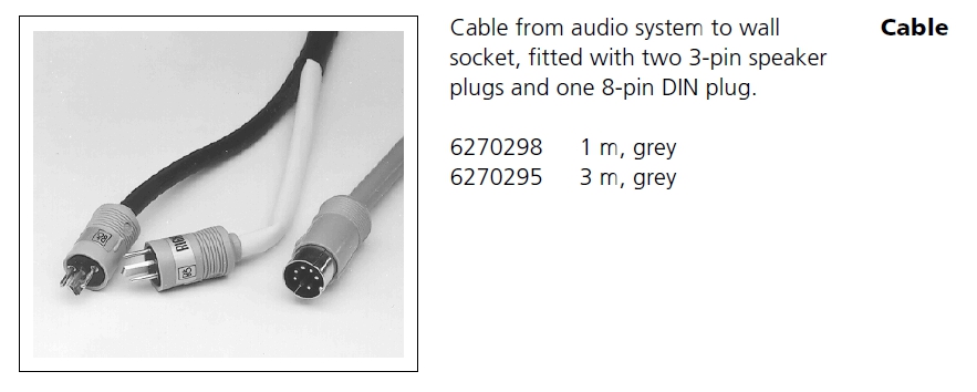

Stoobietoo replied on Sat, Mar 10 2018 10:30 AM
Here's what the cable will look like, but in what ever colour cable Steve provides. (taken from the MCL Handbook)

Hi Stoobie,
Yes, that's the one!  I can build these in any length required, so you aren't limited to the 1m or 3m lengths that B&O used to offer.
