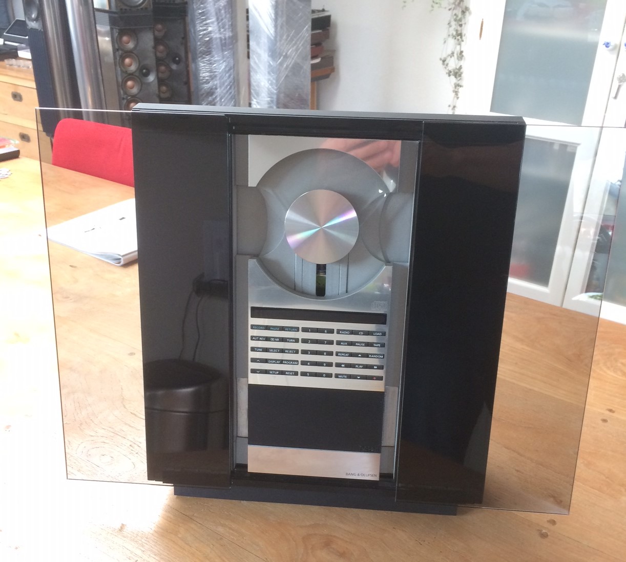

I have an ongoing project, and I am using an Ouverture for this.
A lot of parts I do not need. I at least have a working cd mechanism if someone needs it.
Some other parts also, like the plastic parts and other stuff. Tell me what you need.

and the glass doors never existed.

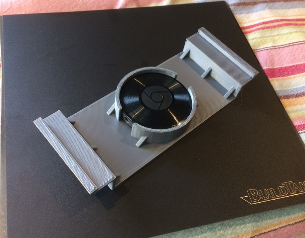

Same here, some experimenting and ejecting the tape mechanism.
Different material used.
Need still some tweaking as the upc expects signals from the tape, which isn't there anymore.

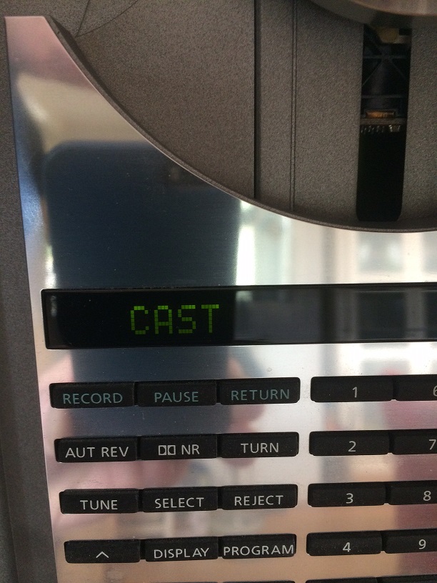

How do you reprogram the display to show CAST?
Do you know if there would be any way to connect a Gramofon to the CD-input and make the remote skip tracks?
leogoeswild: How do you reprogram the display to show CAST?
By scrolling through the software and looking for TAPE and modify that. with CAST then reprogram the chip (if it's a Xicor). For private use btw.

Still thinking over about how to interact with the processor.
I can rebuild a small part from the Tape PCB to simulate the presence of it, or use a Arduino to make it a bit more sophisticated and let the microprocessor know when the music stopped from the Google dongle, so it shuts off automatically.
With this mod, you still will have the CD and the extra A.AUX input for another source at the back.
When completed we could start a topic with the complete modification.
What is needed to connect to the software and reprogram the chip? I have no idea how that works, so teaspoon feeding please :P

Pull the Eprom (27C512 ?) and dump the content with an EPROM programmer (ALI is your friend :-) )
In a Hexeditor find TAPE and replace with CAST, depending on how the software is organized you may even be able to replace with more letters.
...Or whatever else you can think of
The Cast picture shows checksum is not an issue, so simply program a new chip, leaving the old as a backup!
This trick, unfortunately, doesn't work for e.g. your Penta displays since its a mask-programmed device, meaning you cant dump the content of the internal ROM.
