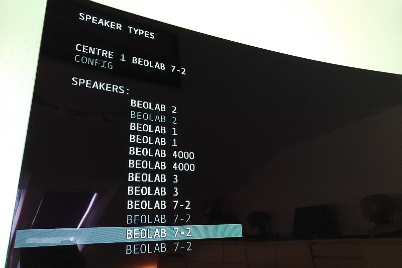

TWG
Top 75 Contributor
Posts 1,672
TWG replied on Fri, Aug 17 2018 5:41 PM
Seems  possible, I just tried it on:
Beosystem MK3, Type No. 7710,
Servicemenu:
Monitor Information
IC3: AP SW: 13.12.a
IC2: IOP SW23.00a
and as you can see I could choose a few more 7.2 in the speaker setup menu.
Evidence: Wink
