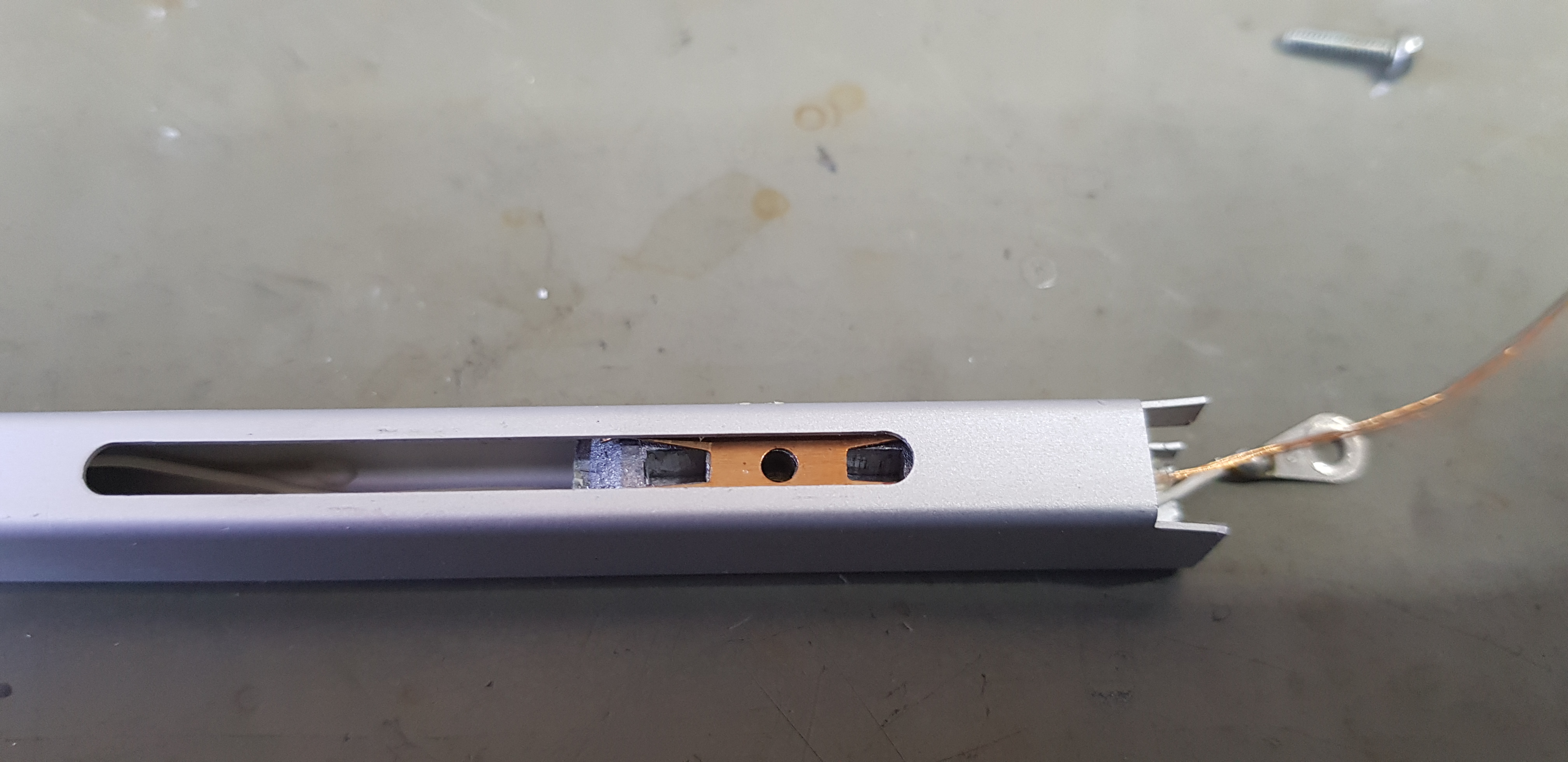

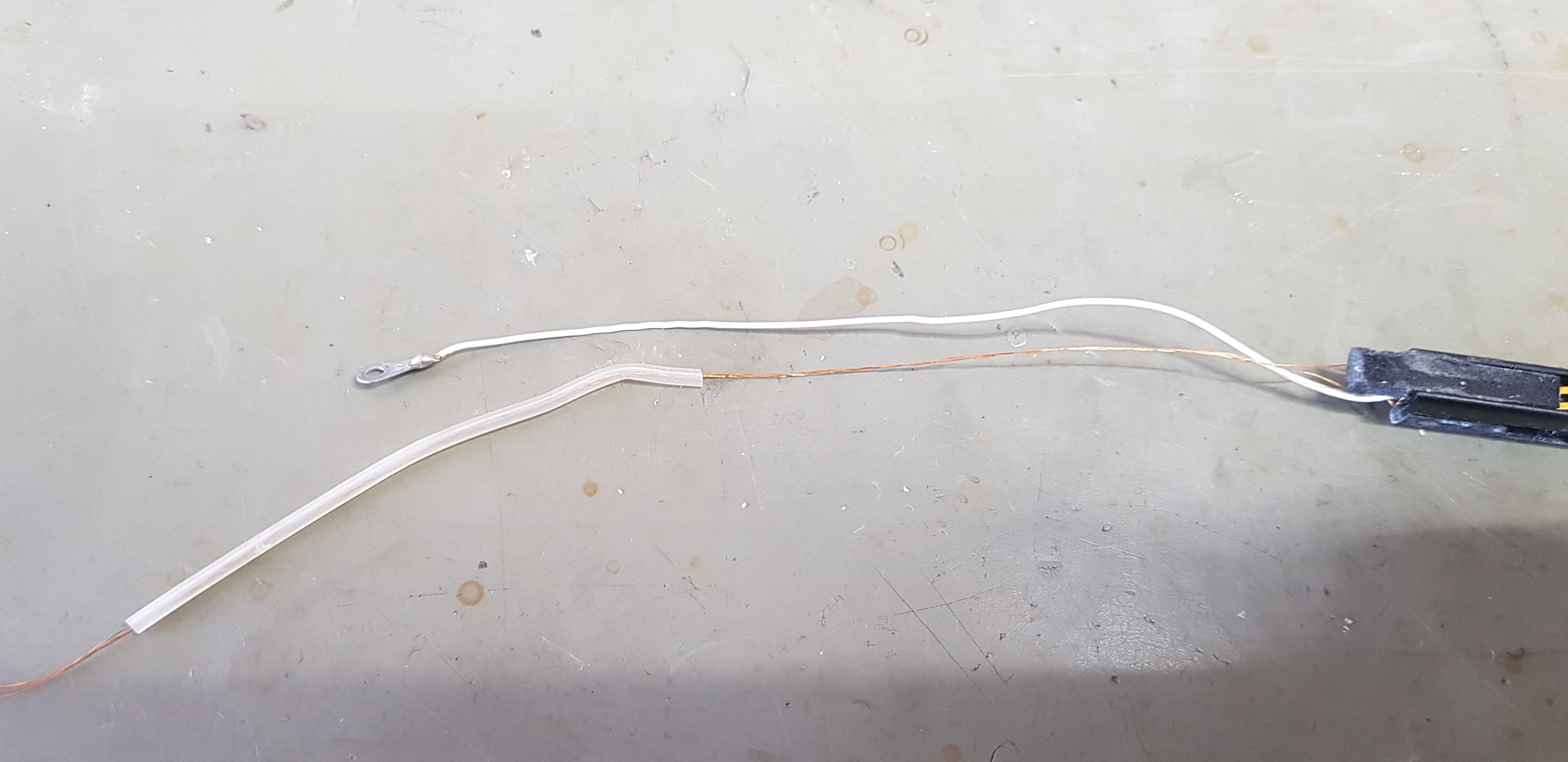

Spassmaker replied on Fri, May 17 2019 12:40 PM
Hello Everybody out there
I've made it!!

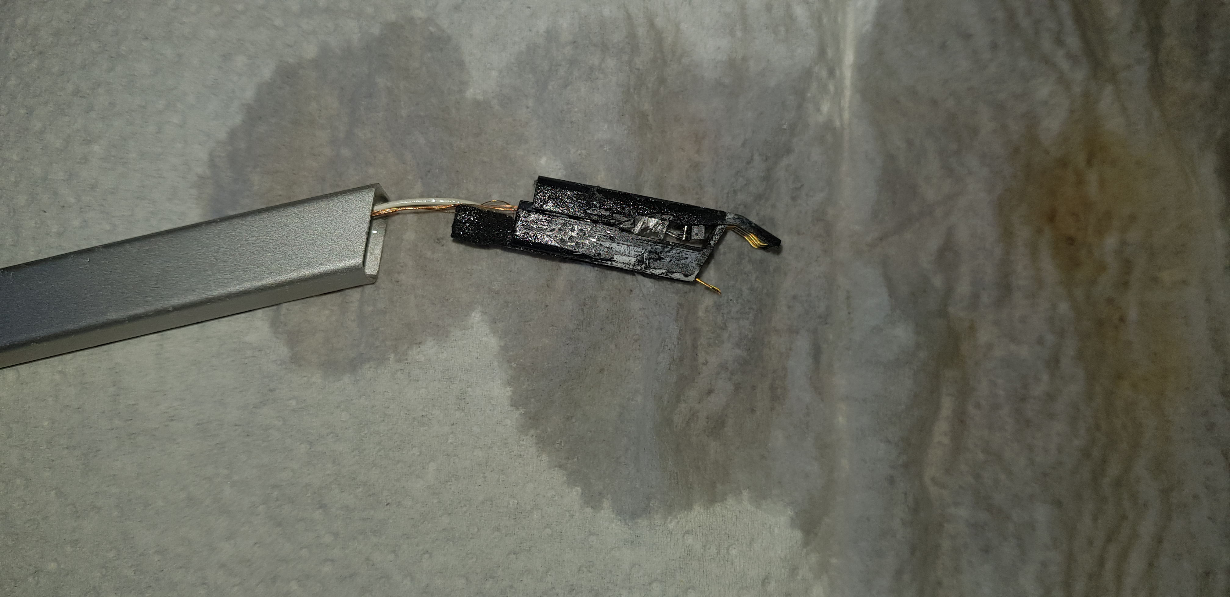

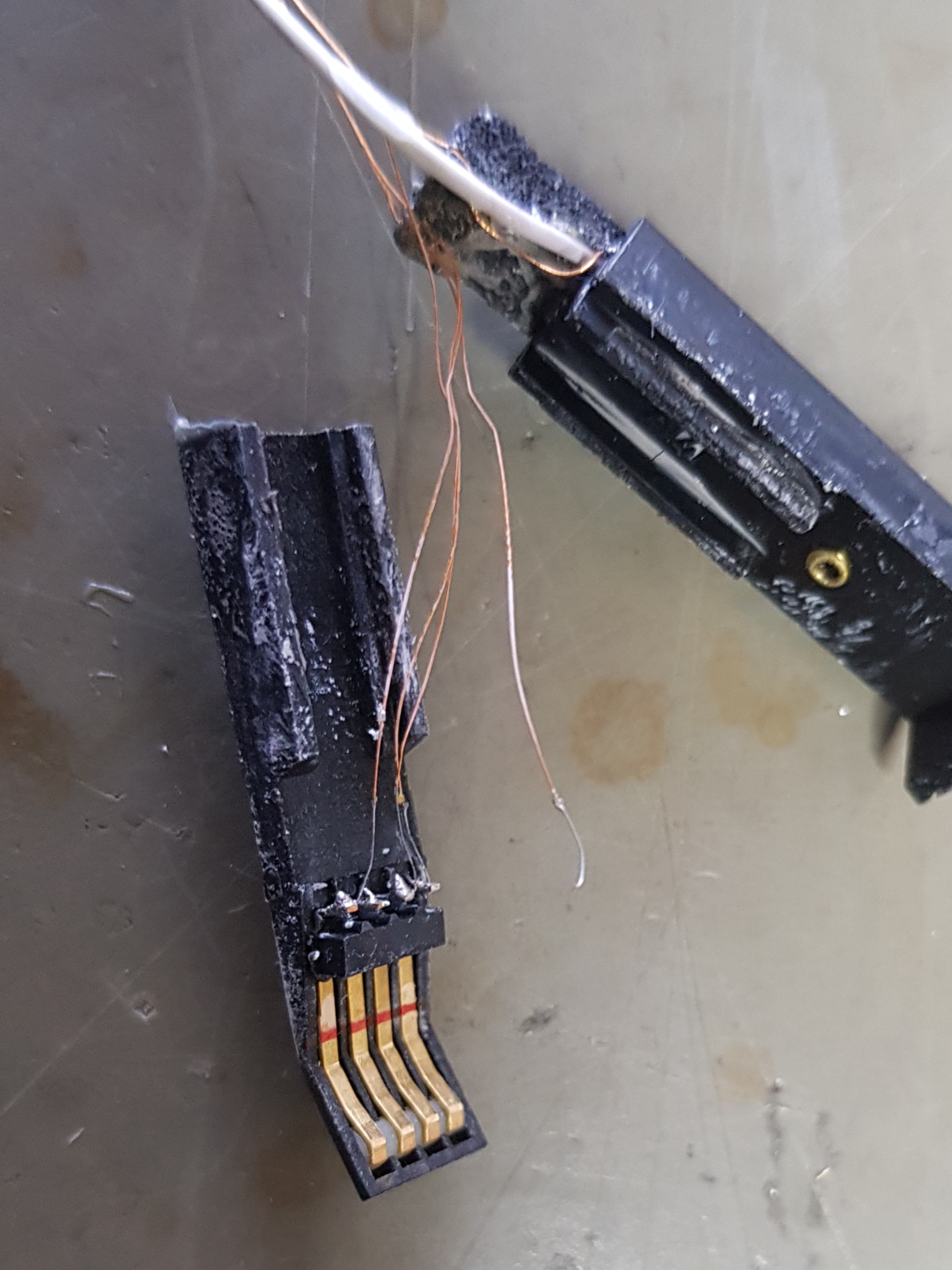

First I  held the Tonearm into cooking water to get the Glue inside the Tonearm loose, but there was no reaction, I cooled the Tip down with some cold Spray and put it again into the boiling water, coldspray again and one more time boiling water and the tip came out with some light pressure from a long Screwdriver.

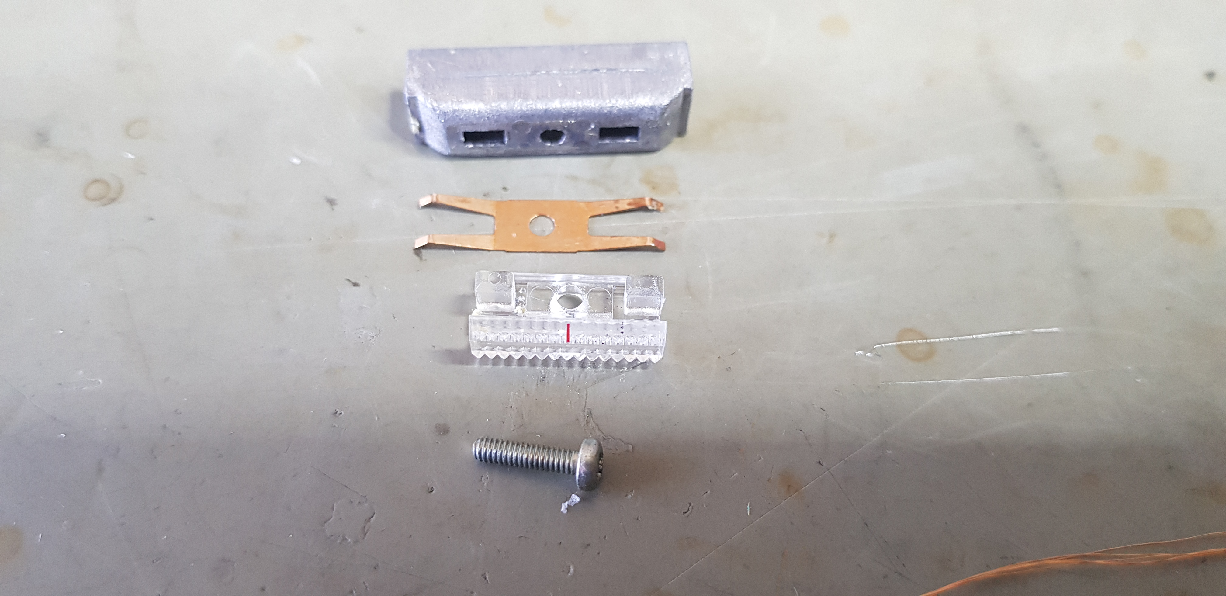

After that I seperated the Top and downplate of the Cartridgeholder like shown in the next picture
As you can clearly see is that one of the very thin gold plated wire has come of the soldering point.
The Wires are fixed with some Glue at the end of the Cartridgeholder.
I realy don't know how this could happen, but anyway I've found the mistake in the wireing.

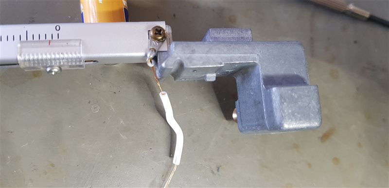

After resoldering I started to reassemble the Tonearm.
I've had to get the Wires through the Silicontubes and around the Tonearn Pivot.
While fiddeling around with the Wires one broke and I could start from scratch.Angry
I took some new Wires from an old relay wich I found in my workbench, good to know that everything is needed sometimes ;-)) so don't throw it away.
The Wires have to be very thin beause thicker Wires could be to strong in the Tonearmpivot and there would be no free movement for the Tangential movement and the Lowering of the Tonearm.
I twisted 5 Wires to one handy cable Chassis GND, LEFT, LGround, RIGHT, RGround
Here are some Pictures of the way I took.

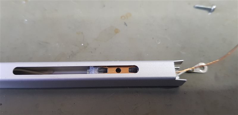

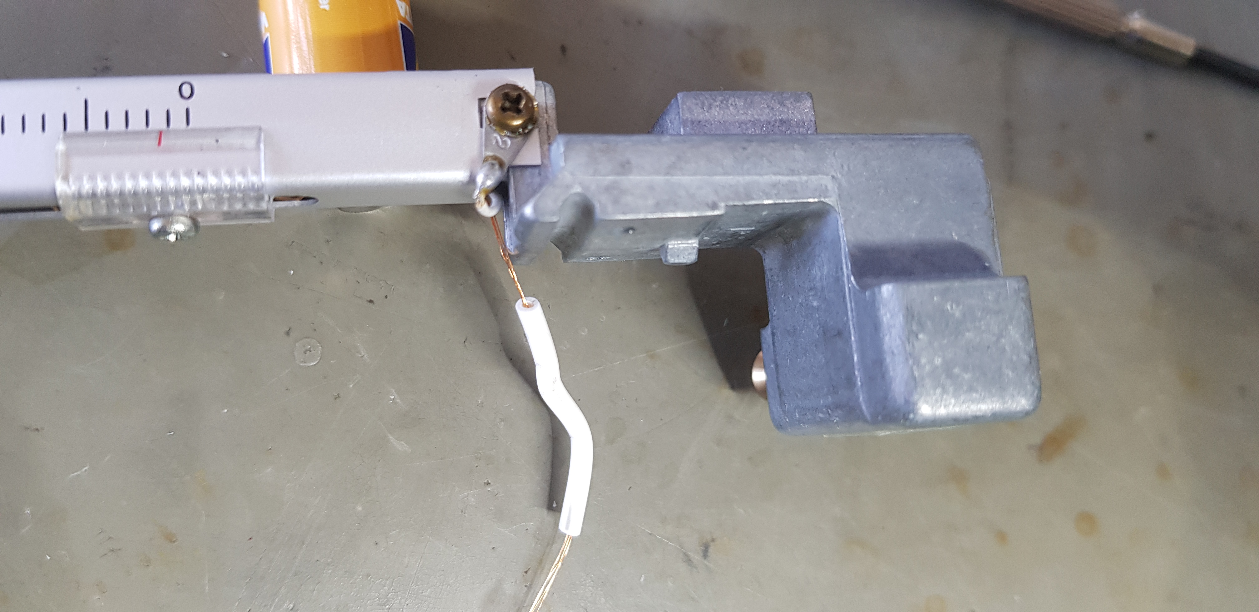

Balanceweight in all parts
Balanceweight mounted, the long Siliconetube runs over the Balanceweight.
Balanceweight mounted and Tonearm mounted.

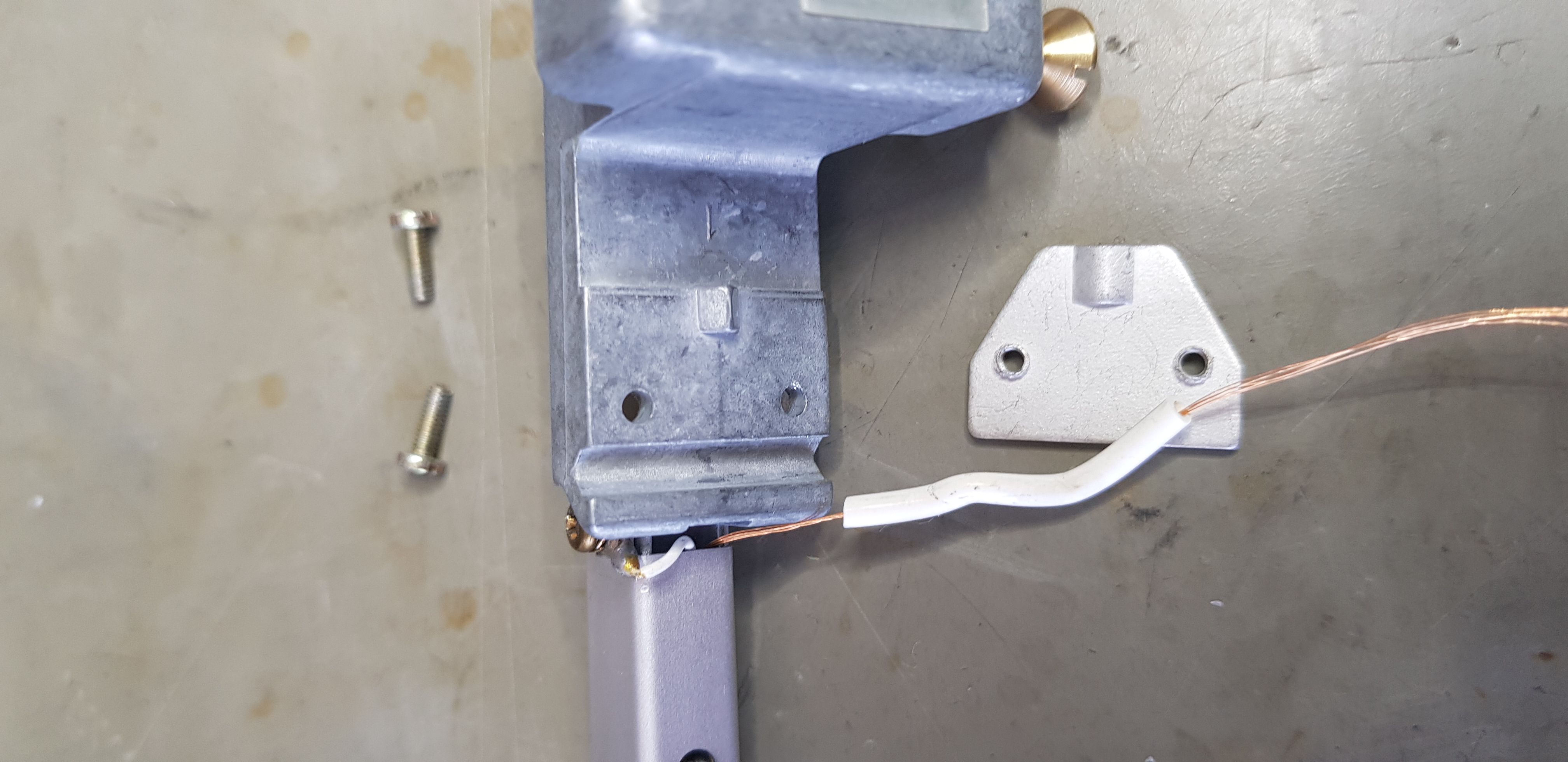

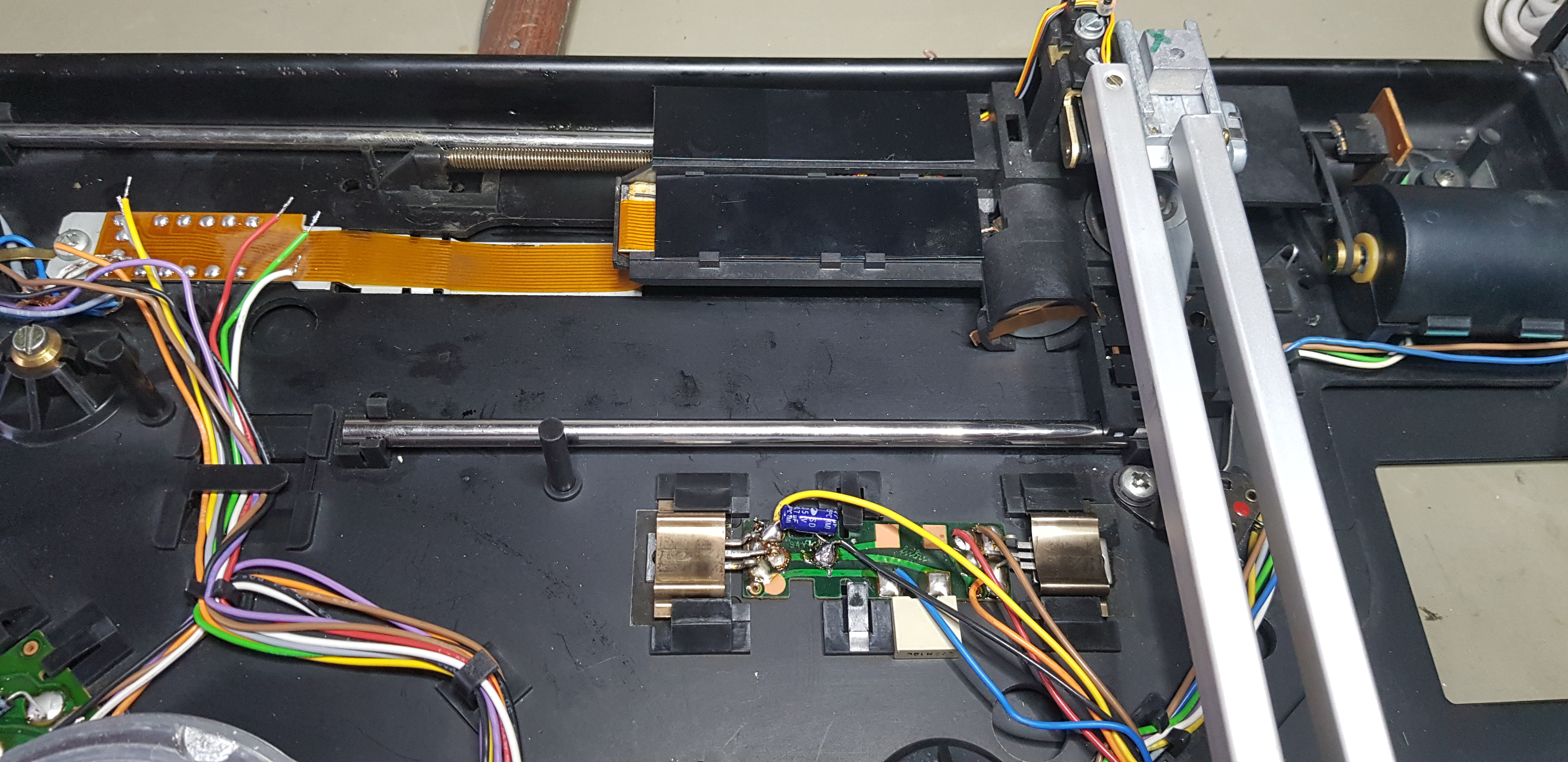

Beware to keep the small GND Latch to the RIGHT corner, because later the Tonearm won't lower when the Black Plastichub come on.
Here it is wrong.

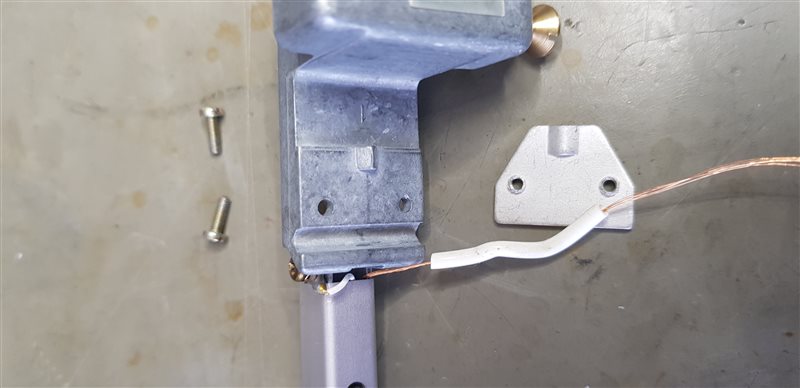

The plate wich connects the Tonearm to the Pivot.
In the Meantime I reassembled the rest of the Tonearm without taking more pictures because I had no free hand for the camera.
One Tip is to glue some thick tape at the Bottom of the hole near where the cabling comes out of the Pivot to not damage the new cabling while handling the Tonearm to get it in plcae.
You have to pull the cabling very smooth to get it good in place.
