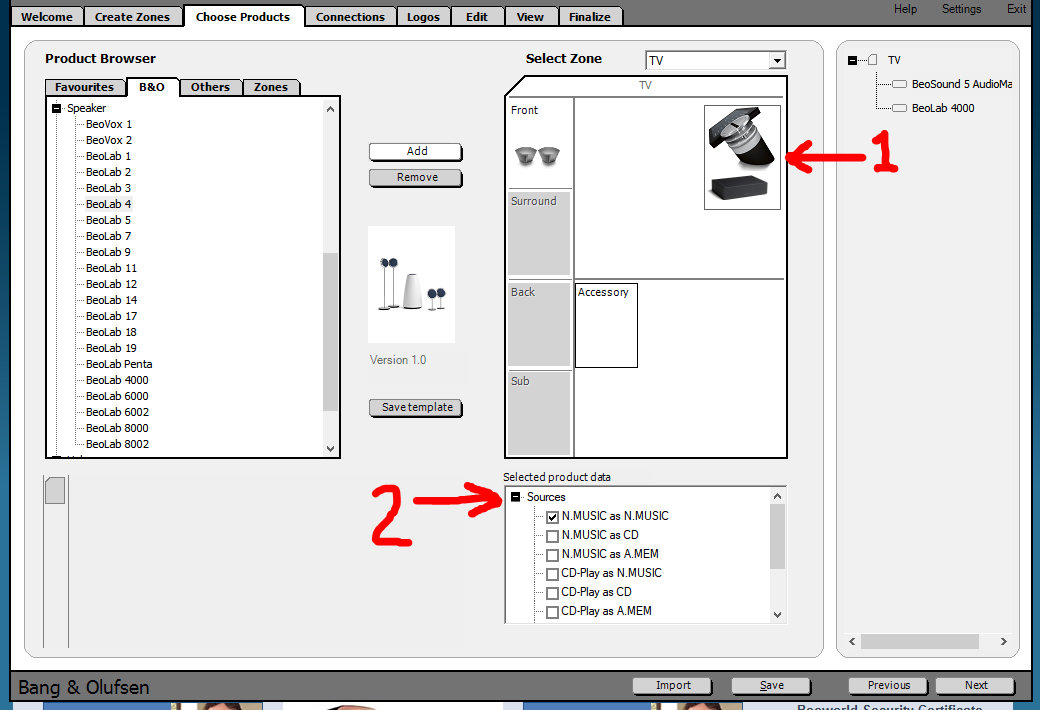

I was messing with my configuration today and thought I'd make a file with the BeoSound 5 and Beloab 4000. I don't know of you saw the box where you have to tell the remote how to send the signal for NMusic and NRadio.
In the configurator, go to the "Choose Products" tab, click in the BeoSound 5 picture then in the box below that you will see the "Sources" with a +
Click on that and you need to chose the correct option for NMusic then scroll down for NRadio. I don't know which is the option you need so you may need to try each one.
