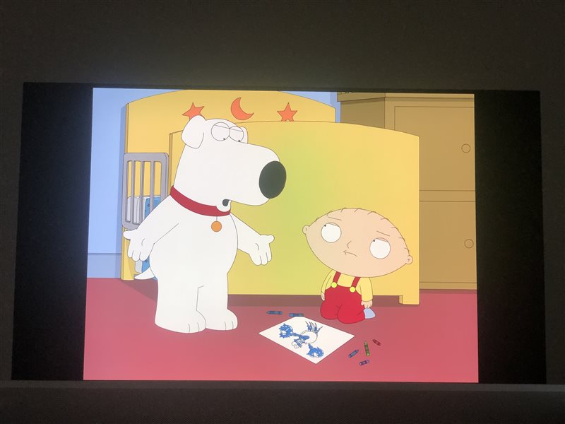

My BV Eclipse 65” has screen burn in the center. It’s a grey green cloud in the center and has an odd bar across the bottom. Since it’s over three years old now, I assume it’s not covered under any type of warranty. I don’t have any dealers around me and B&O support has been very slow to get me any answers.
Has anyone had to replace the LG OLED panel on a 65” eclipse? Do you know what the cost is? I’m also thinking about waiting to see if you will be able to upgrade to the CX panels on V2.

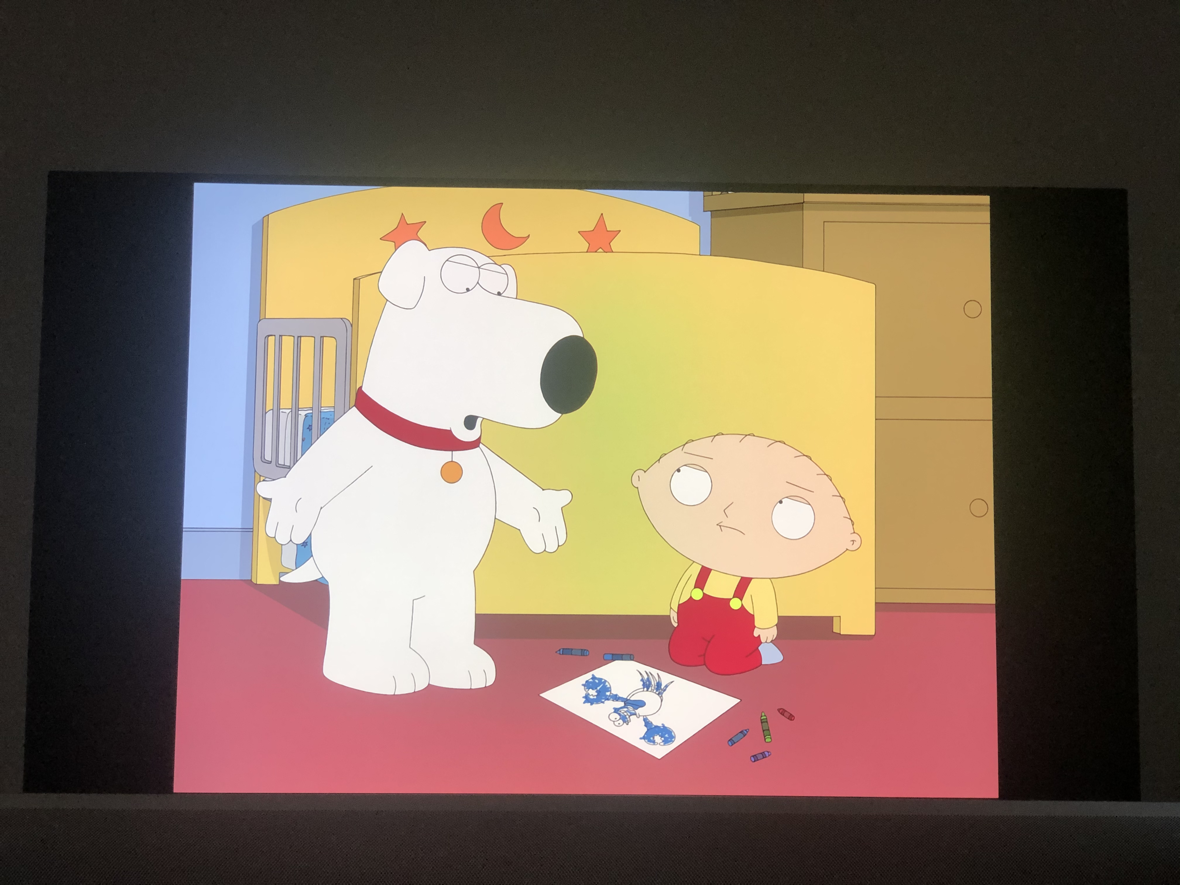

I took a photo of what's happening. This is just an example. The entire bed is supposed to be yellow. It's very green in the center. There's a large patch that makes any warm tones really green or gray. I think the board overheated in the center and damaged the panel.
Emil Jensen
Denmark
Posts 766
That is not burn in,
But still very bad, it would have been on warrenty.
Very unluckly

Austin is your eclipse in a sunny room or sometimes have a lot of sun on it?
