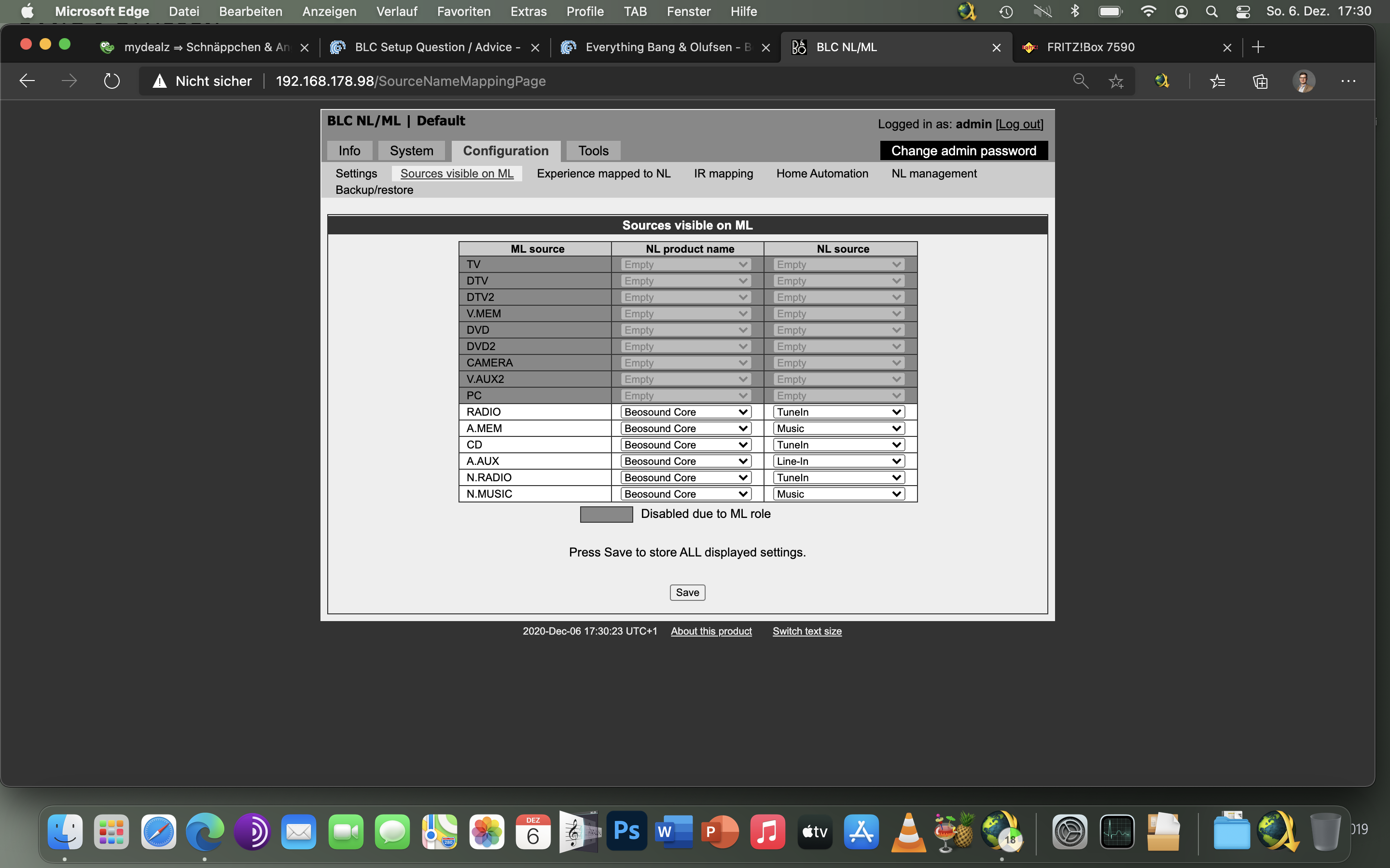

How did you set the BLC (V.Master, A.Master, A.Slave.....)?
Did you set the NL sources to be seen by ML in the BLC-settings? And how did you set the IR-mapping in the BLC?

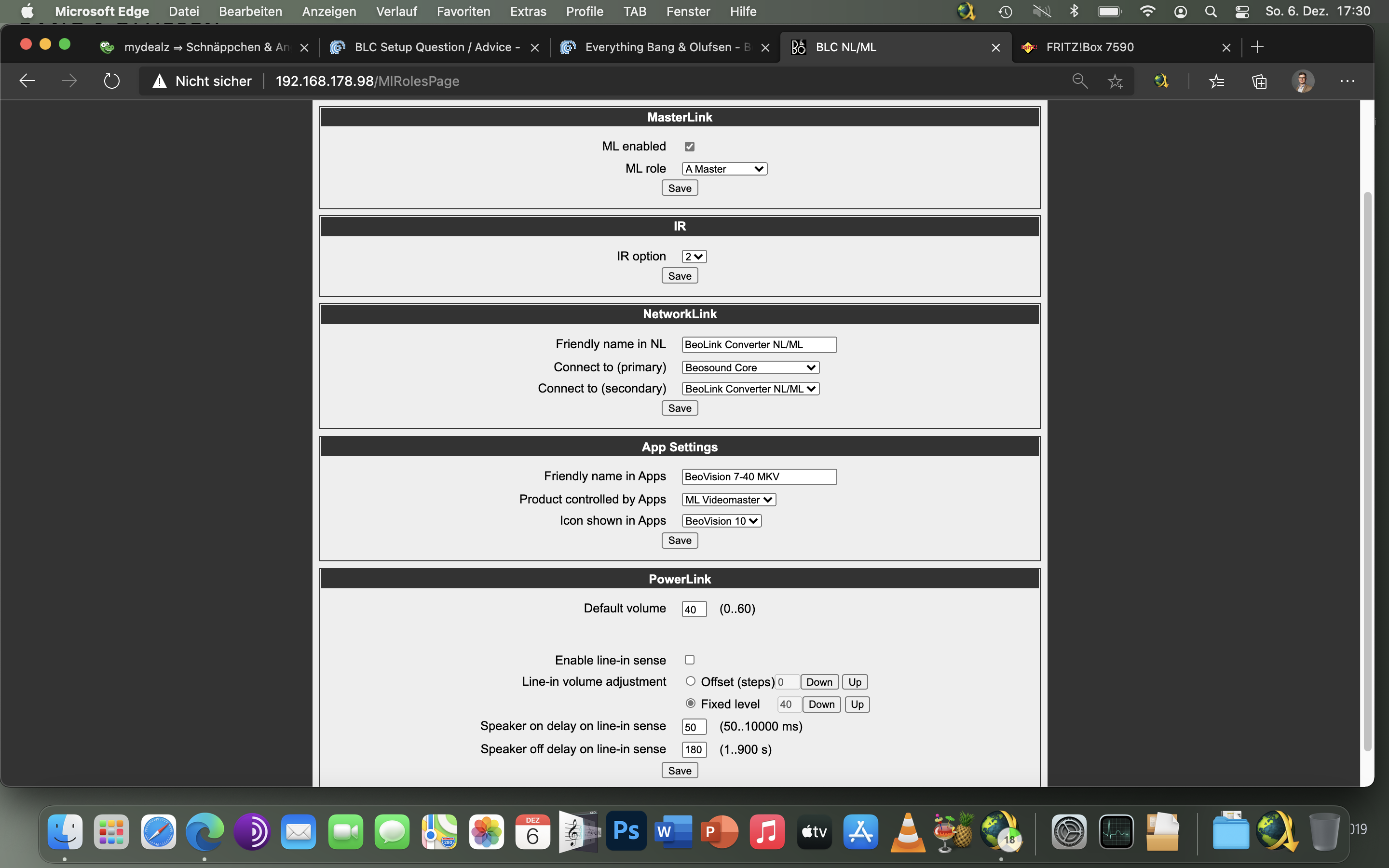

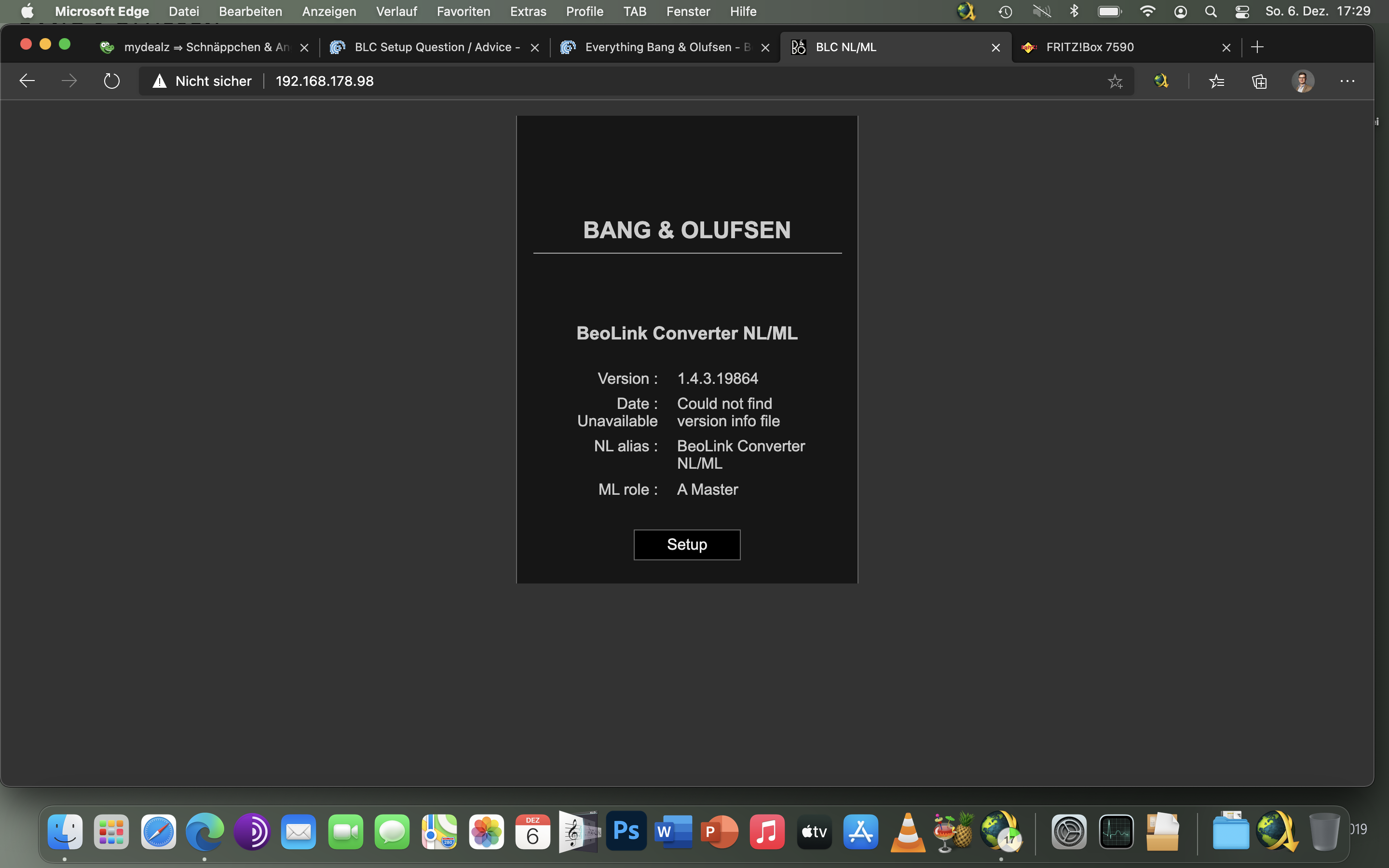

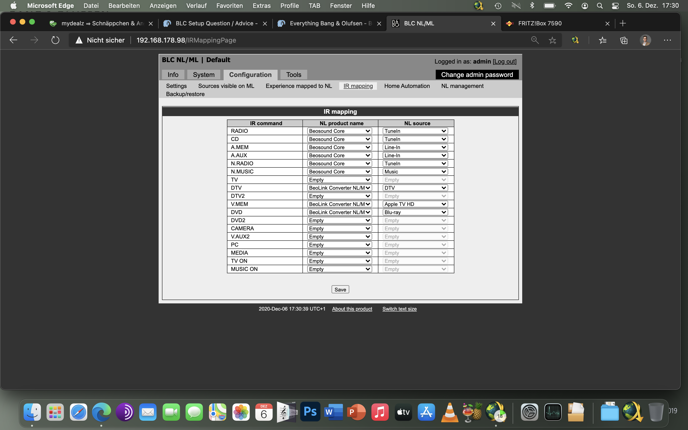

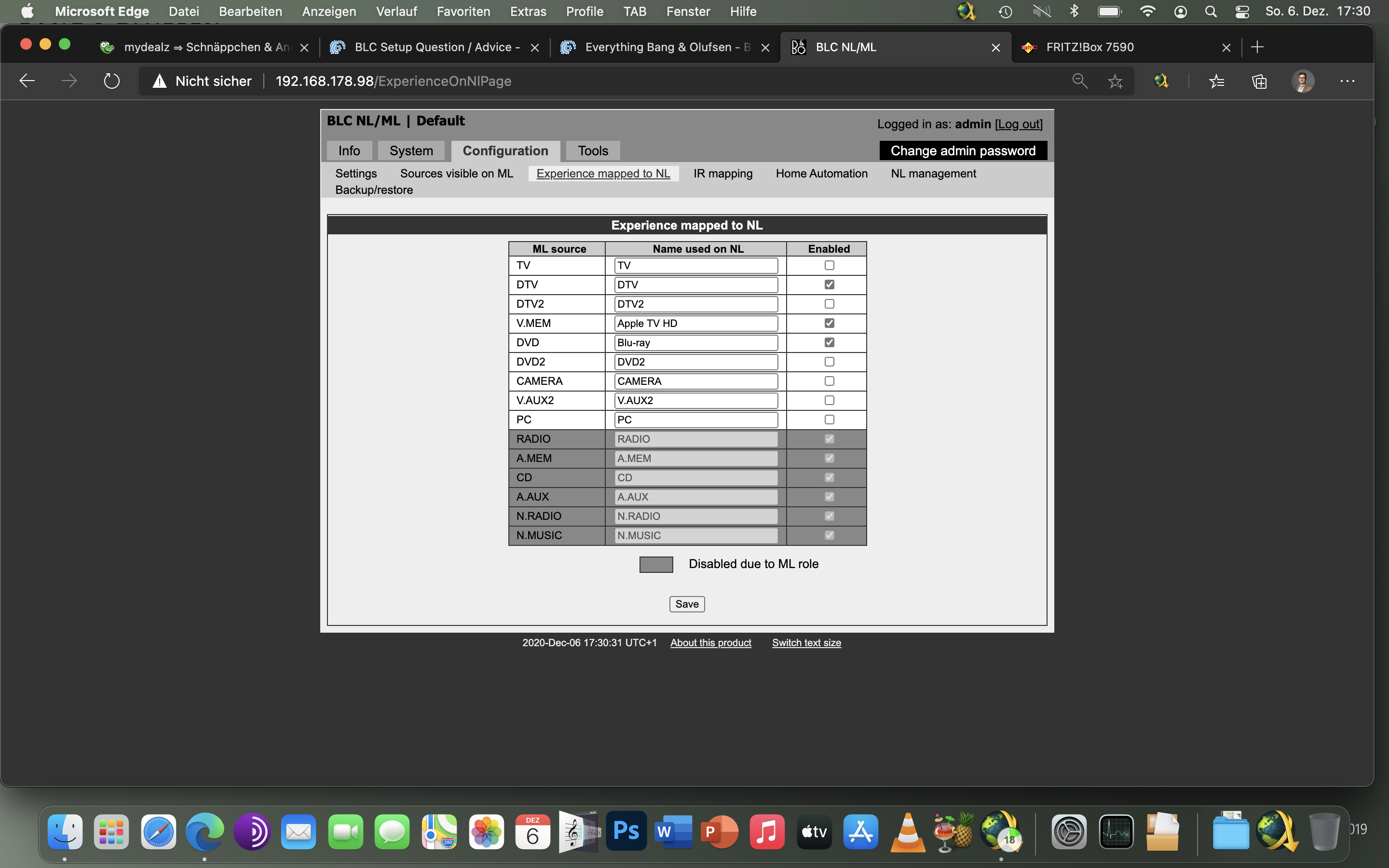

The BLC is set as Audio Master, The BeoVision is on Option 2. Everything is on the same network and currently the only think connected to the BLC via Masterlink is the BeoVision.
Is there a way to check if my BeoVision ML Socket is damaged? This is the only idea I have left.

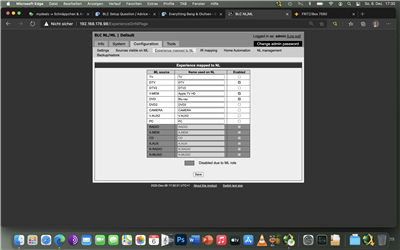

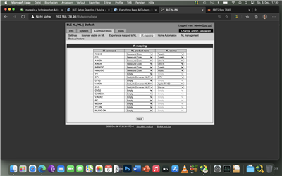

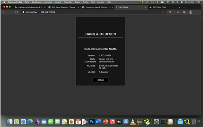

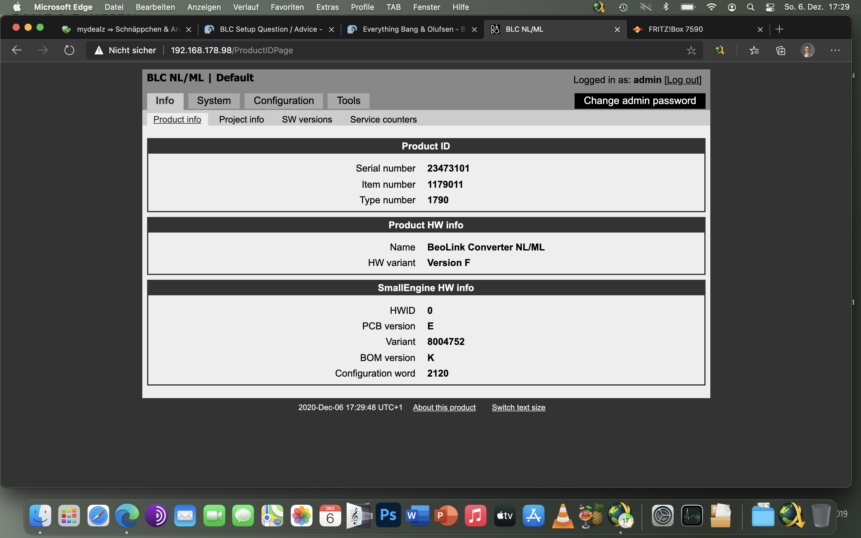

Here is my setup of the BLC in pictures. https://archivedforum2.beoworld.org/members/Tim84/files/BLC+Setup/default.aspx
