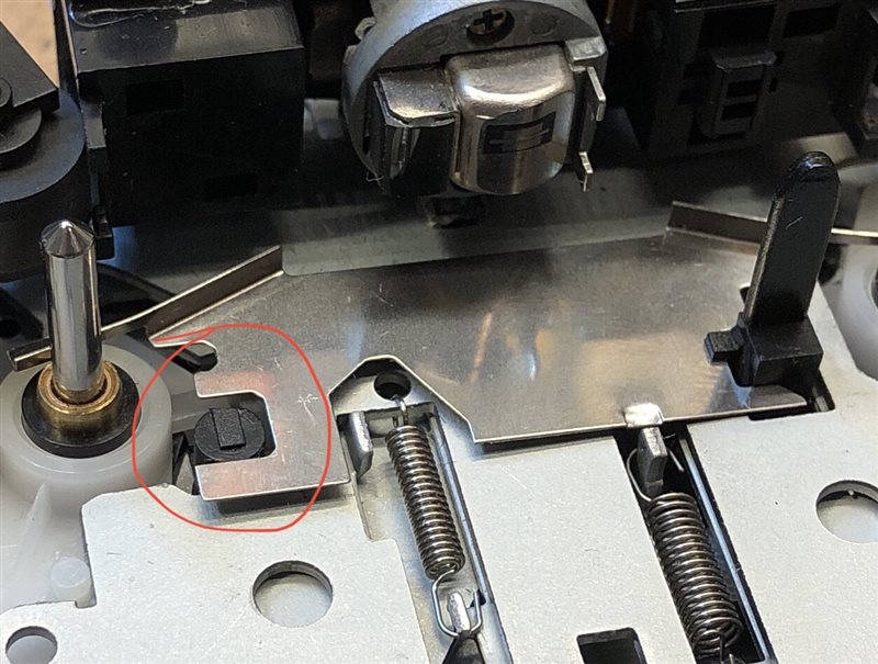

Dillen replied on Mon, Feb 1 2021 7:04 PM
Check if the static discharge plate has broken off its holder.
If one of its "arms" is not on the bearing (brass collar) but instead on the capstan, it can block the tapeheads from engaging.
Red circle shows it broken off, and the arm (just to the left of it) is resting on the capstan.
The other arm (sadly out of view in this photo) is resting correctly on the side of the bearing.

Ignacio replied on Tue, Feb 2 2021 4:54 PM
Thank you Martin,
Yes I guess this could be my case.
The black plastic pin seems to have lost the retention and the static plate is not flat.
Do you know how to fix the plate, I mena can I glue the static plate to the chassis and bend the arm to touch the bearing?

Dillen replied on Tue, Feb 2 2021 5:20 PM
Yes, glue the metal plate to the remaining parts of the black plastic tab (carefully not to smear glue in places it shouldn't go).
And then move the arm to touch the brass bearing rather than the chrome capstan.

Ignacio replied on Tue, Feb 2 2021 6:42 PM
Dear Martin,
Unfortunately your kind suggestion did not solve my problem. I bend the arm to precisely touch the bearing but nothing happened.
FF/RW smooth and silent runnig but when I push play, the head try to engages and after first try in one side move to the other rotating the head as supposed, repeting this sequence two times until stops.
