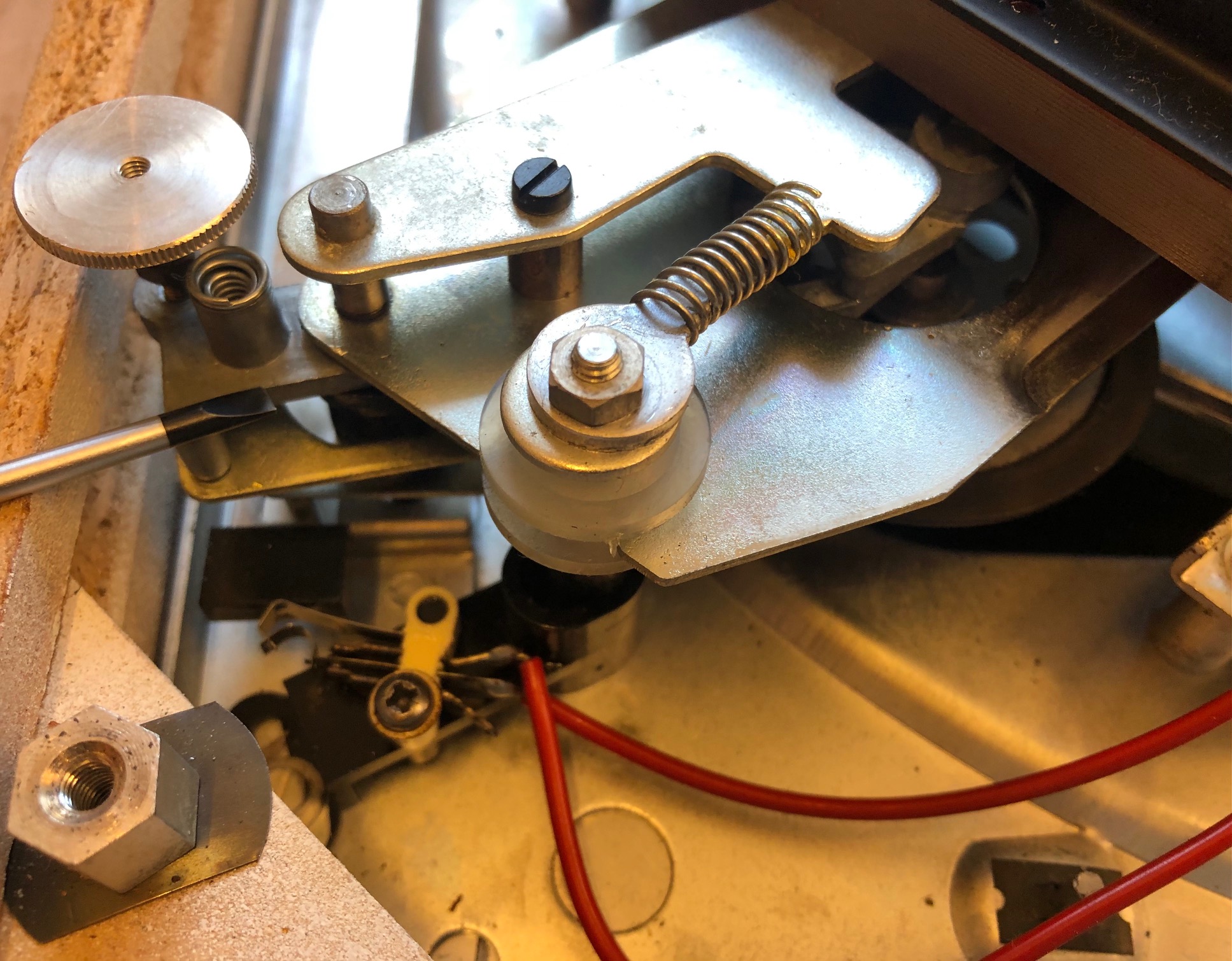

It turned out the idler wheel assembly was completely stuck. After a few drops of oil it came back to life :-)
As said the deck is almost like new haven't seen much use if any, that's probably why it was stuck.

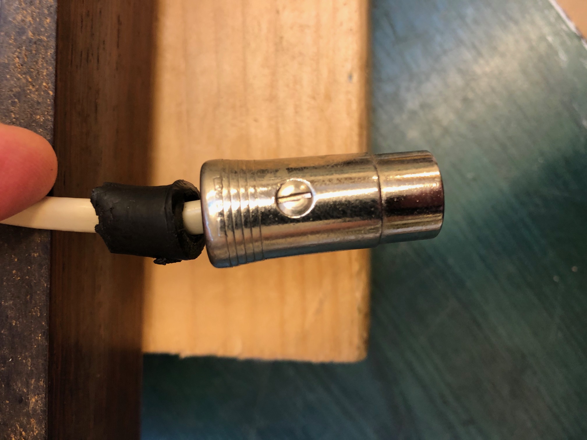

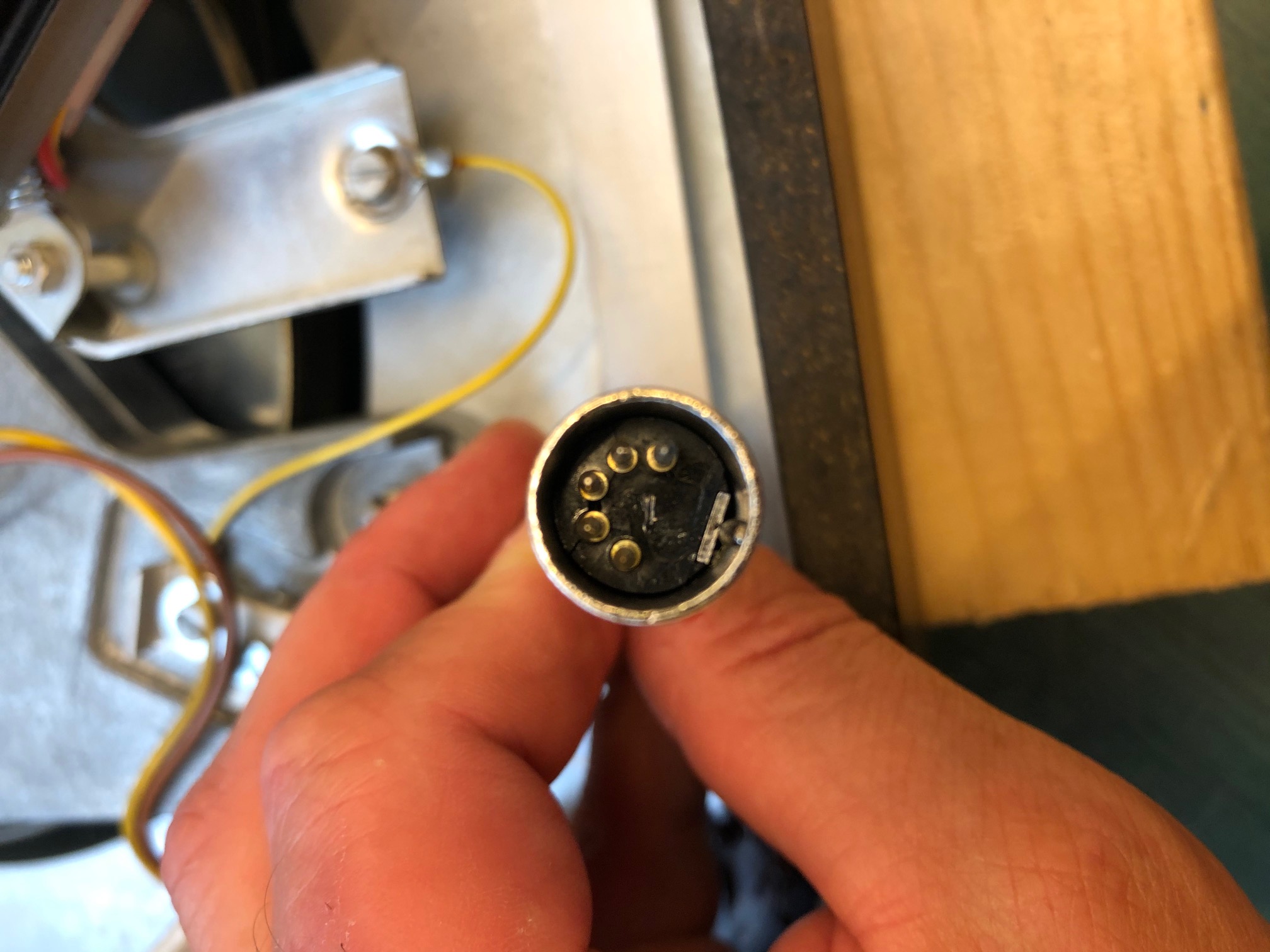

So now it is spinning completely silent but when turning it on there's a terrible noise in the loudspeakers. It's not from the pickup, have tried with a different one. My guess is the very old DIN plug, will take a look at that tomorrow.
Idler wheel assembly

OK, the DIN plug was broken inside and the black wire almost disconnected, so that accounts for some of the noise. I got a new plug and soldered the wires on after making sure there were continuity on all wires. So now it plays without weird noises, so far so good.

Problem solved! The new plug was garbage so bought a way better one and now all is good :-)
