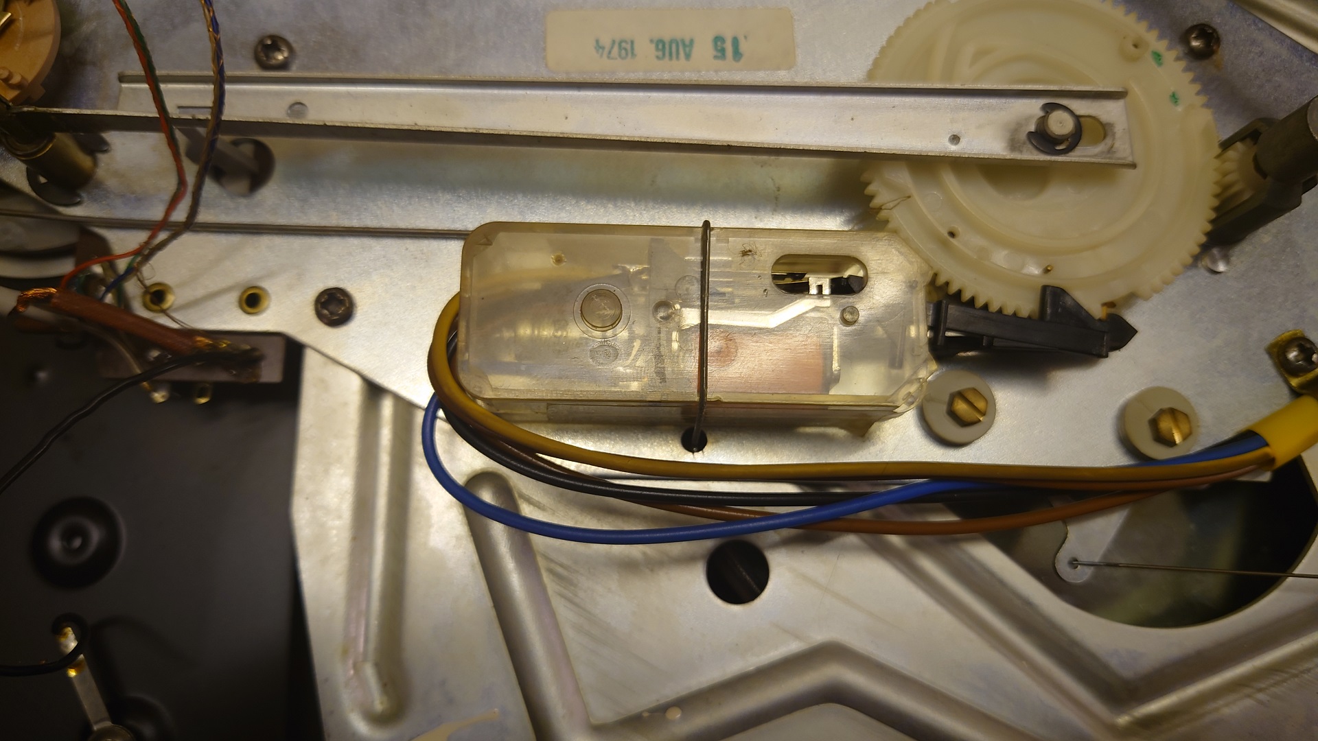

I am a very proud new owner of a Beogram 1203, however I have isolated that the relay switch in the player is not working and the broken wire is likely deep in the winding. Is is at all possible to find a replacement relay switch or are they near impossible to find?
If anyone has any information not these or even one lying around I would be hugely appreciative.
Details of the relay are: SPEC V2/M/90R V11 (orange paper casing). I can't seem to upload a photo but it is contained in the clear box on the underside of the player.

It’s highly unlikely that you will find a replacement unless to find another 1200 series to cannibalize. Your best bet would may be to rewind the coil.

I thought that might be the case. Have unwound it a little bit but not found the break yet. I think I will keep going with it and keep checking eBay for parts in the meantime. Thanks for the help.

I have the coil you`re looking for,i can not guarantee that it will work,but you can get it for free,you only have to pay for shipping
Send me a pm if you are interested.
