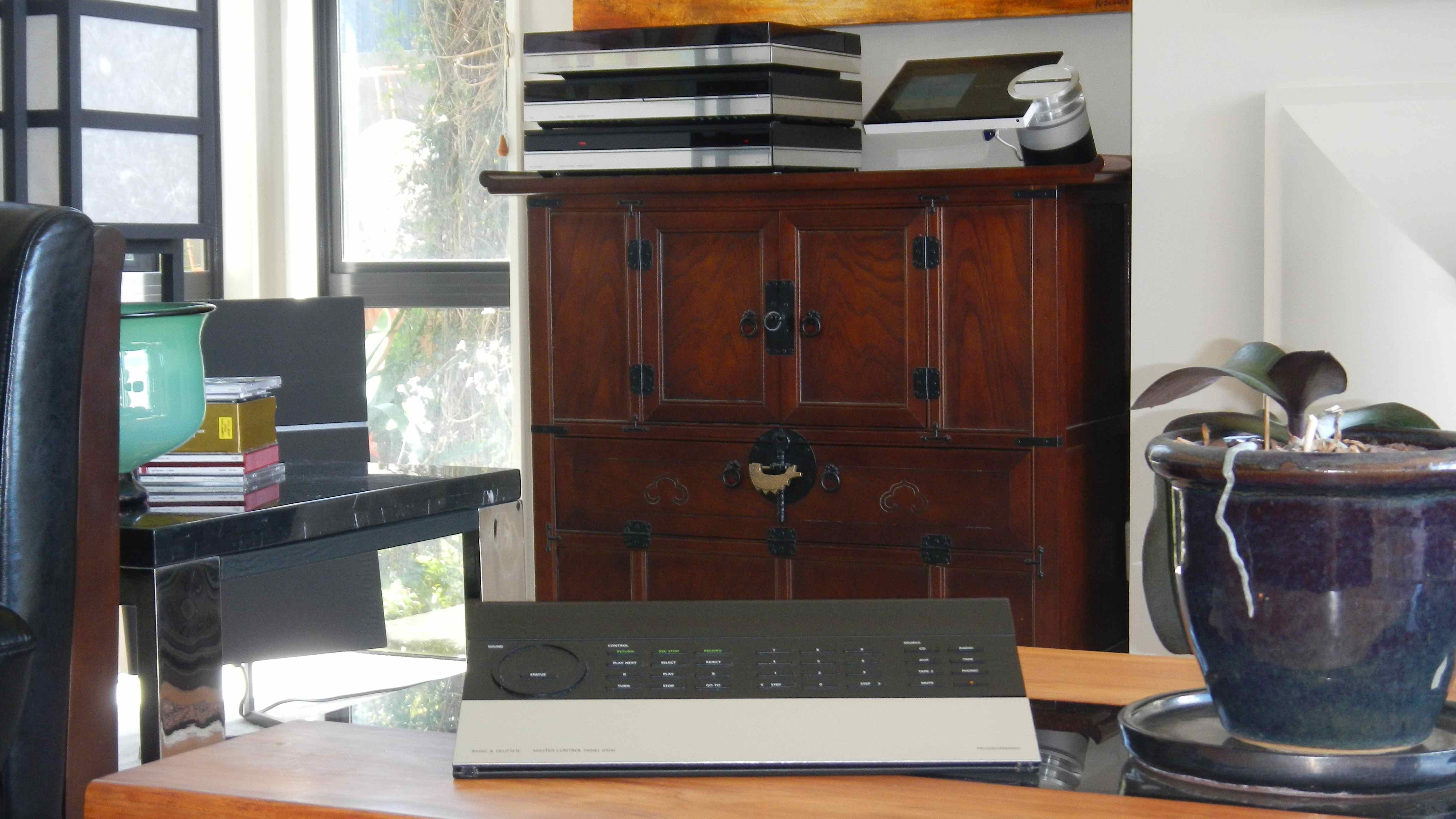

I've attached a picture of my set up to help explain. THANKS!

When it comes to suggestions, I would go for a 'PowerLink switch'.
Have a look at:
http://almando.com/index.php/b-o/almando-powerlink-switch-stereo.html
This device was discussed several times on the forum, and would make it possible to control both systems just as it is meant.
For convenience you would have to put either the Encore or the 5500-Master into 'option 4' - I would suggest the least used.
Please tell us on the forum how your set up finally will be , and if you are content with the way of controlling it - when time (and the BL9) comes.
P.S. You could use the same solution with your passive speakers, if you add a 'ML/MCL Converter'/'BeoLink Passive' as an amp for them!
