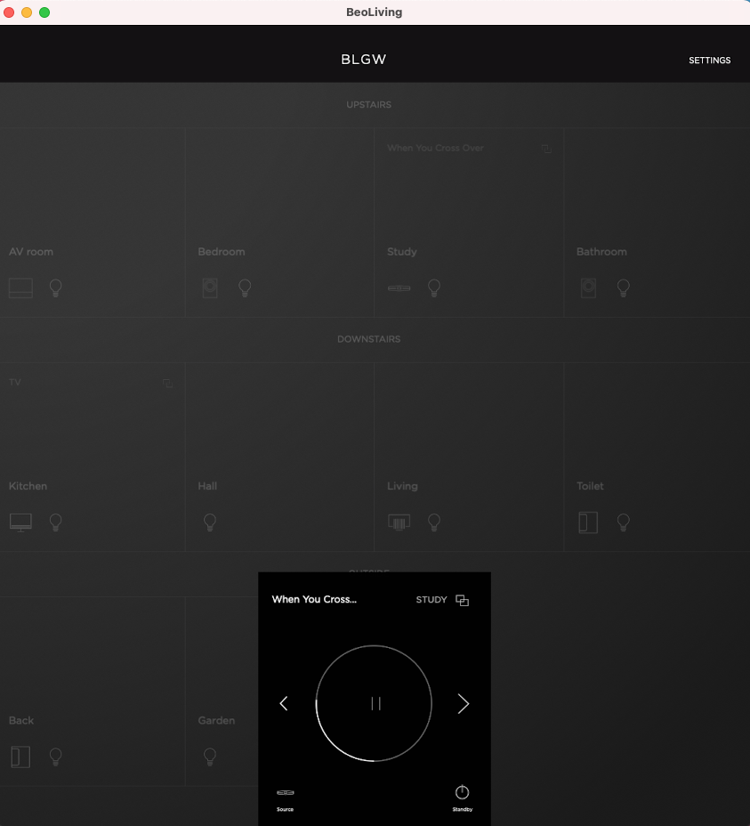

2. Well, I have finally chosen the station and now just enjoying the music, but suddenly need to go somewhere. I take my phone, login to app and then I need to open the room and source to be able to shut it down...
Actually you can shut down on the starting screen. Just tap the device icon in a room

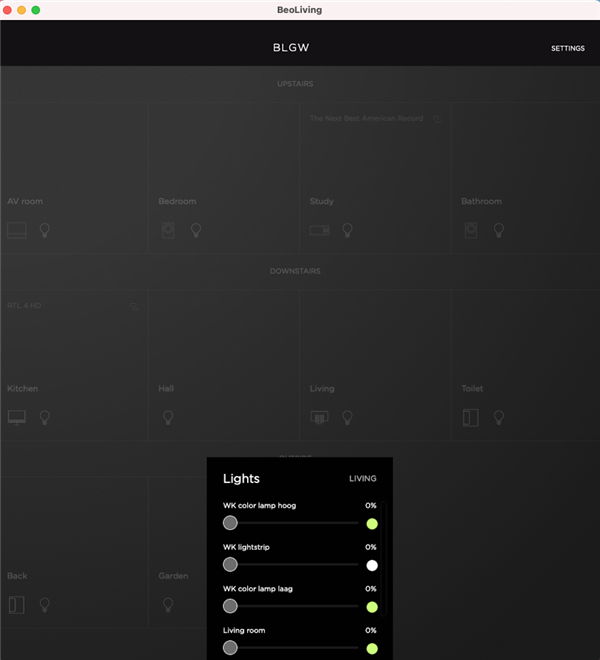

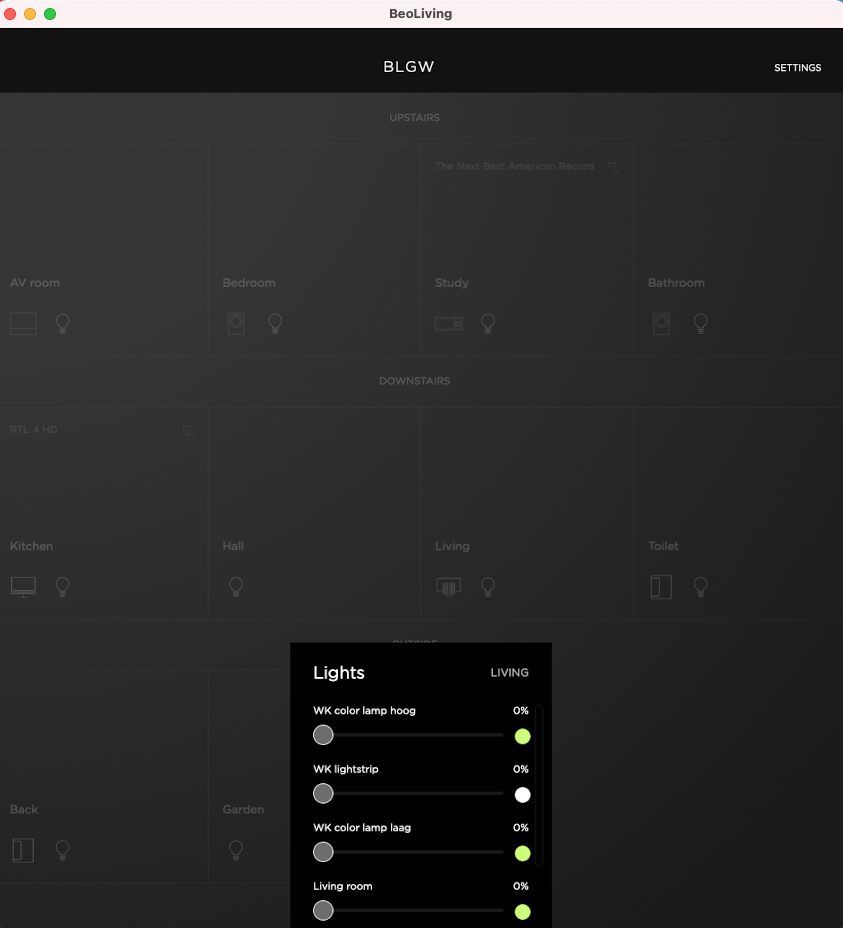

you can also quick access the other available functions (lights, controlls, thermostat etc). Just tap the icon
