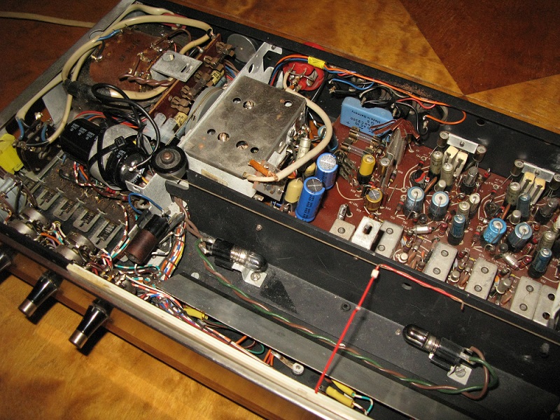

Beomaster 1000 in surgery
posted by Jeppe
Thu, Jan 5 2017
File size: 262.9kB
Filed under:
Beomaster 1000, white keyed version, during organ transplant. The larger capacitors have been replaced. The fried silicon transistor that someone had put in exchange for the original AC128 germanium transistor has been removed and a new old stock AC128 soldered in, with a home made "heat sink". From being completely dead the Beomaster sounds beautifully.
